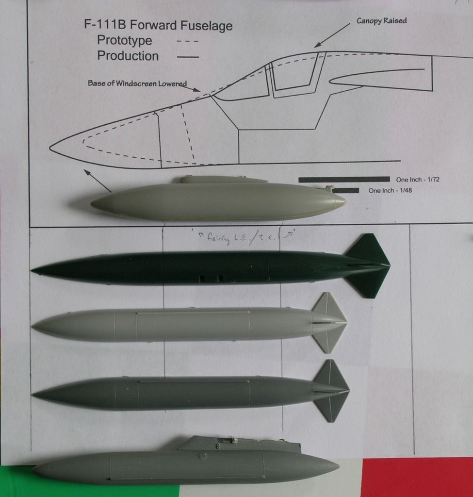

Drop tanks:
The length lines should be accurate- I found stations in a General Dynamics structural breakdown.  From left to right:
  • nose point (aren't you glad that I told you?)
  • first joint, which begins the totally tubular section
  • second joint, end constant diameter section
  • (to the right of any tanks) aft point as should be
(the pencilled "fairing" points are where the shallow fixed mounting base is)
At the top is a tank salvaged from the scrapyard- a wee bit fatter (scale about 30" diam), which may actually be right (EDIT: comparing proportions to a near-profile view suggests 30" is about right- does anyone have a reliable dimension?)  All of the rest are about the same diameter.
The dark green tank is from Monogram's A-10
Light grey is Hobby Boss FB-111
Dark grey is Academy F-111
Bottom tank Monogram (?) Phantom
Notice how much "blunter" the Hobby Boss ends are compared to the others.  I'm tempted to work up a "master" of the right size (especially if I can nail down the diameter!) and either have a club member cast a few for me, or give it to Roy Sutherland, or both.
incredible that now body seems to get it right....
I 'd favor the last option somehow .....
question: is there a difference between FB-111 tanks and lets say "normal" ones?
Edited by exdraken

I have got four left over tanks from the Academy EF-111A. I think I will try to lenghten them to the correct size.
By the way, can you measure the A-10 tank for me?! So I know the correct length (in milimeters please). Thanxs

12 hours ago, trickyrich said:
nice comparison Bob, but it would be useful to label which is which?
My "photoshop" skills aren't that developed, but I DID say which was which in the text:
The correct length of the actual tank is 299 inches (158.22mm in 1/48).  I'll have to look up the other points again.  EDIT: first join 103" from nose tip, second join 196".  "Mounting pad" leading edge at 126.65, trailing edge at 207.5
now you expect me to read as well! :D Anything more than 3 lines and I'm stuffed!
All I know now is I have to buy some tanks now from OzMods!  I wonder if they have a frequent buyers club??
