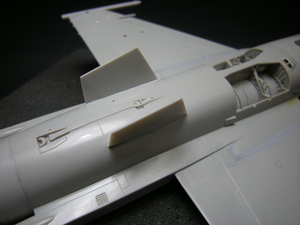

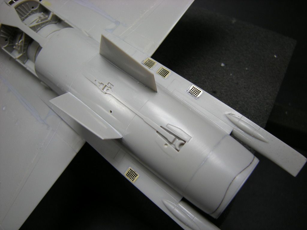

Pappy Posted January 14, 2017 Author Share Posted January 14, 2017 G'day people, Not much progress today as I spent most of the day surfing at the beach instead, however, the ventral strakes have been added, I will need to add a couple more CMDS dispensers to the lower fuselage next. I probably should have done that before getting the fuselage together, oh well, cheers, Pappy 1 Link to comment Share on other sites More sharing options...

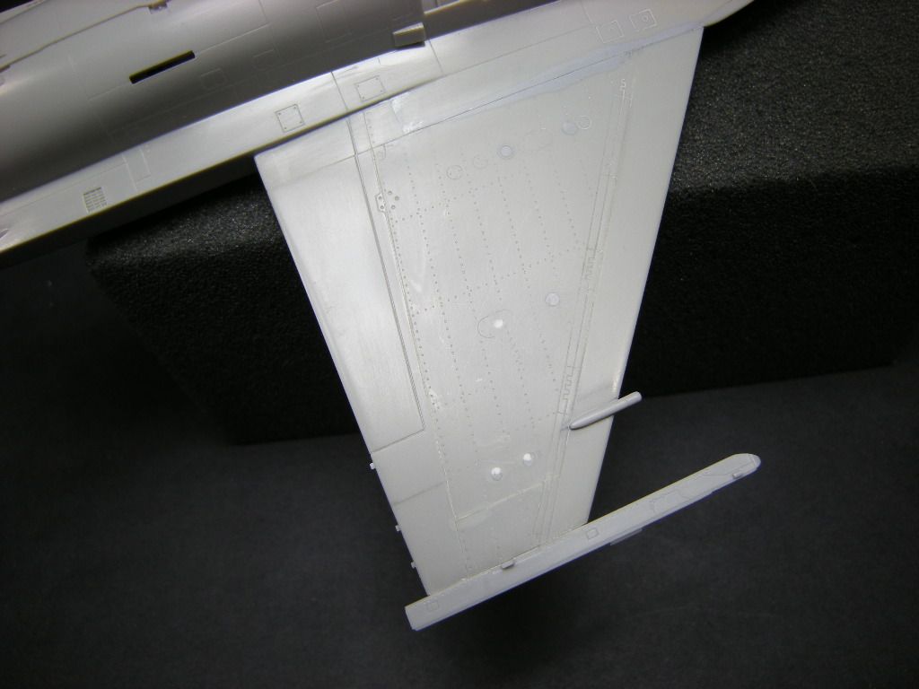

Pappy Posted January 16, 2017 Author Share Posted January 16, 2017 (edited) 11 hours ago, modelling minion said: Quite right, back to your wonderful F-16 build please! I was wondering how long you guys would keep that up. Back to regular programming, G'day people, I forgot to post this update. Hasegawa's later F-16CJ and block 50/52 family of F-16's include the later LAU-129 pylons. More importantly, the instructions provide very precise measurements for attaching the LAU-129's after the original older style wing tip pylons have been removed. Hasegawa very helpfully supplies the lower wing halves with all the pylon location holes already opened, usually I like to load up my jets but unfortunately, in this instance I want most of mine filled as my jet will only have a minimal stores load. I filled the holes by first punching out a styrene disc and then adding a few drops of CA. cheers, Pappy Edited January 16, 2017 by Pappy 2 Link to comment Share on other sites More sharing options...
trickyrich Posted January 16, 2017 Share Posted January 16, 2017 we could probably go on for ages.... That's different that they have the holes open for the pylons....it's usually something I forget to do before gluing the wing together! Glad you use the plastic method, filler just never quite works and it can be very messy. Link to comment Share on other sites More sharing options...
Pappy Posted January 21, 2017 Author Share Posted January 21, 2017 G'day people, The next job I have tackled was one I had to work myself up to. The F-16A/B was originally provided with just two chaff/flare dispensers, one each side on the fuselage underside aft of the wings. While passable, by modern kit standards this is a little dated. Through the course of the F-16s life its design has evolved to meet the anti-missile threat. This has meant that the small, sleek airframe has grown a number of lumps and bumps which are featured on the later F-16s, as well as some retro-fitted to earlier versions. The later F-16 variants now have four chaff/flare dispensers, one on the right as before, but the left side now has three dispensers. The PE set provides four of the required ALE-47 dispenser faces. I was tempted to just fit these over the top of the fuselage, but in reality, the dispensers are flush with the skin, so the PE facings would have to be recessed into the fuselage. I was not really looking forward to this job as I had already assembled most of the kit. A smart man would have performed this task prior to assembling the fuselage. Anyhooo, I just put on my fave CD and got on with it. I drilled out the extant dispensers and cleaned up the hole. I also used this as an alignment reference for the two other dispensers on the left side Once all four were done, the PE faces were dropped into place and thin CA was run around the edges. cheers, Pappy 5 Link to comment Share on other sites More sharing options...
vppelt68 Posted January 21, 2017 Share Posted January 21, 2017 6 hours ago, Pappy said: Once all four were done, the PE faces were dropped into place and thin CA was run around the edges. cheers, Pappy Don't I just love it when it sounds soooo easy for You guys that have the talent! V-P Link to comment Share on other sites More sharing options...
trickyrich Posted January 21, 2017 Share Posted January 21, 2017 7 hours ago, vppelt68 said: Don't I just love it when it sounds soooo easy for You guys that have the talent! V-P you do know that the one you see at the end was the one that was prepared earlier! Link to comment Share on other sites More sharing options...

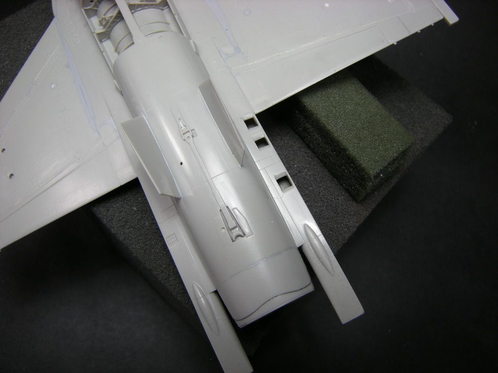

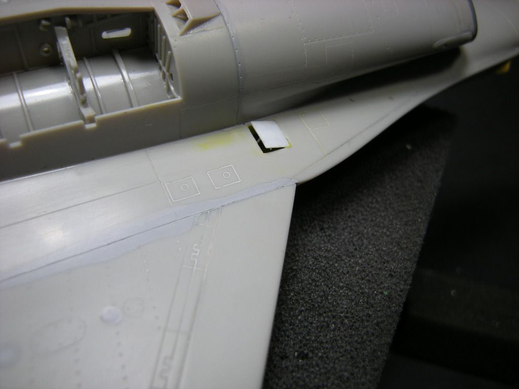

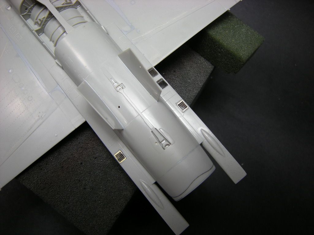

Pappy Posted February 4, 2017 Author Share Posted February 4, 2017 G'day people, I have managed to get some bench time on this one in between other stuff. The ALE-47 dispensers have been faired in The gun vent door added cheers, Pappy 2 Link to comment Share on other sites More sharing options...

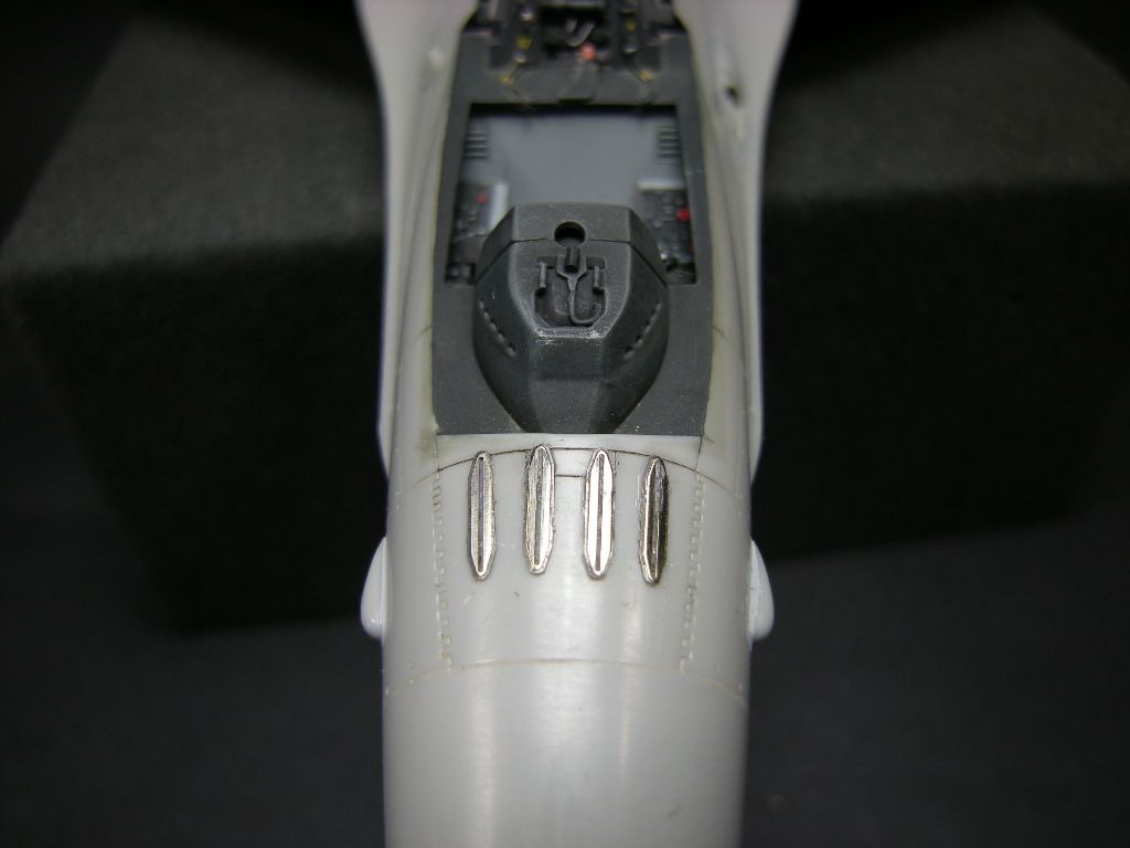

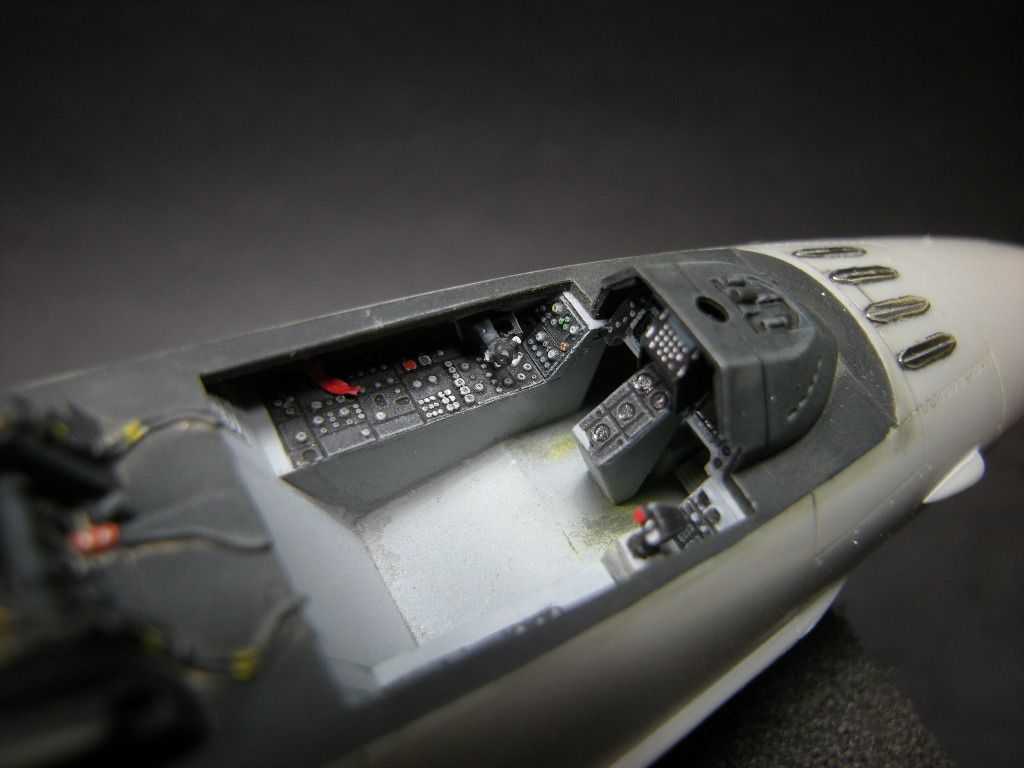

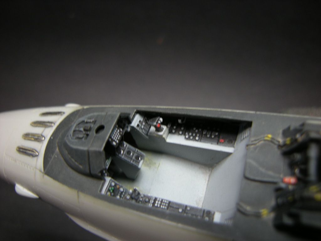

Pappy Posted April 16, 2017 Author Share Posted April 16, 2017 Well, unfortunately real life got in the way of me completing this kit before the GB came to an end, but I have made a little more progress today. The throttle and sidestick controller have been added to their respective locations I have also experimented with something new (for me!), I added some pastels around the cockpit sill and turtle deck area to simulate accumulated dirt Only a few more items to add to the cockpit before I call it done. meanwhile, the bases of the IFF antennas in front of the cockpit have been added I will add the antennas themselves once all the painting is complete to prevent me breaking them off during handling, cheers, Pappy Link to comment Share on other sites More sharing options...

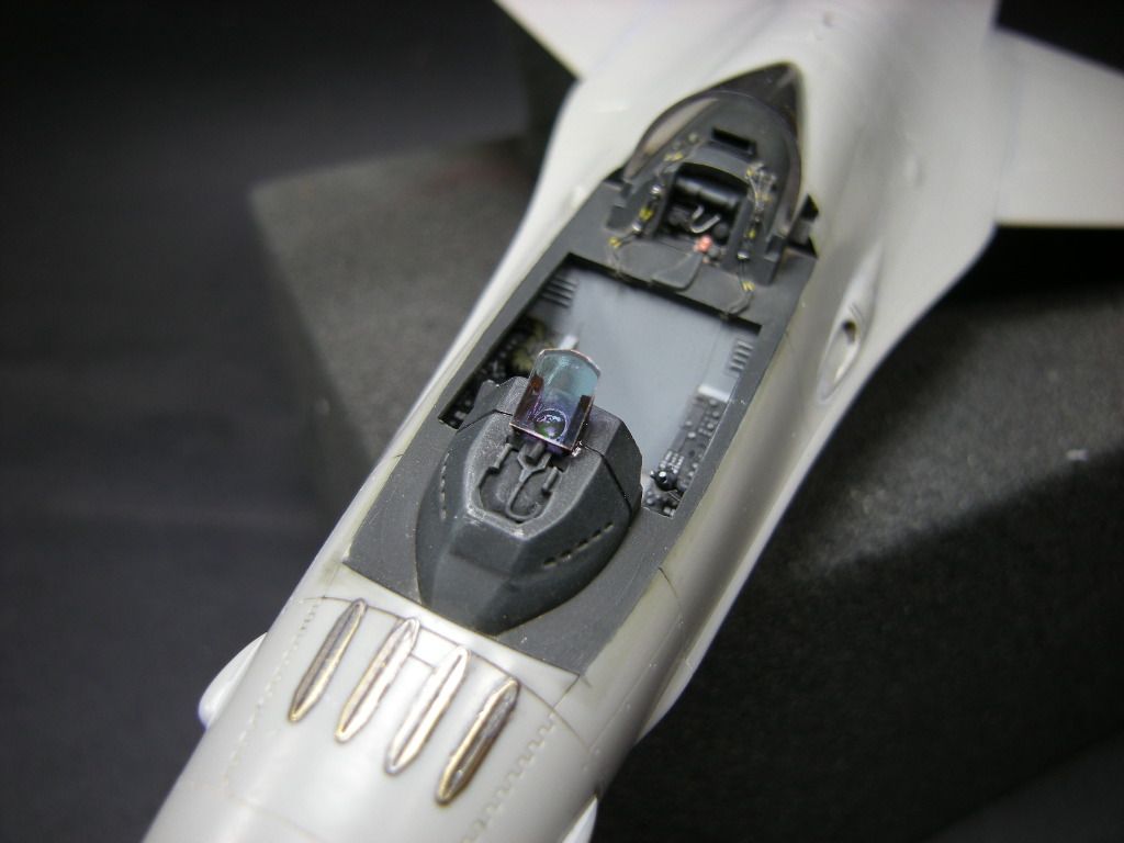

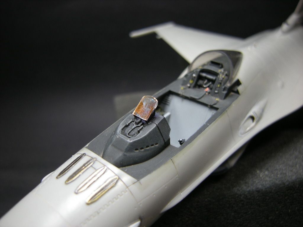

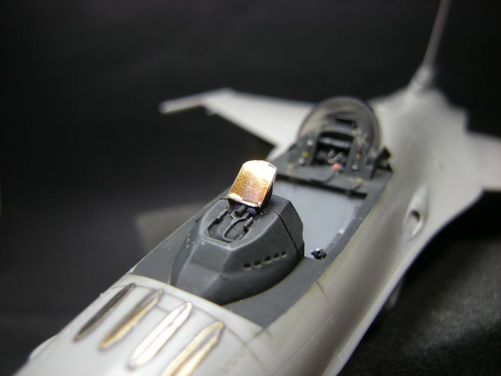

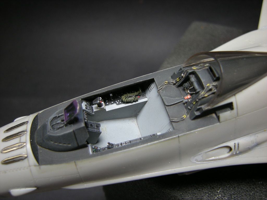

Pappy Posted April 21, 2017 Author Share Posted April 21, 2017 G'day people, I have added a little more cockpit furniture. The oxy/comms hose was scratchbuilt using various diam. of copper wire. once painted up it was added to the aft right console Next up the HUD. I used the kit item with some prismatic film attached to the combiner glass sourced from Christmas decorations that i had saved. cheers, Pappy 4 Link to comment Share on other sites More sharing options...
Janremco Posted April 21, 2017 Share Posted April 21, 2017 Great work Pappy, good eye for the details. Jan Remco Link to comment Share on other sites More sharing options...

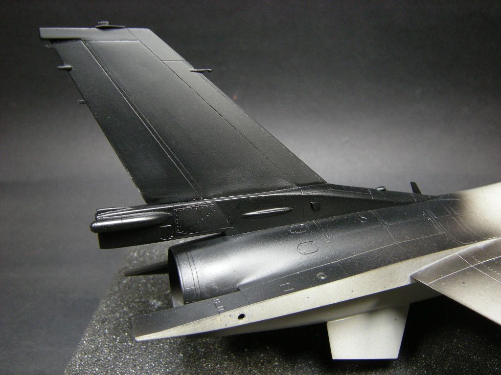

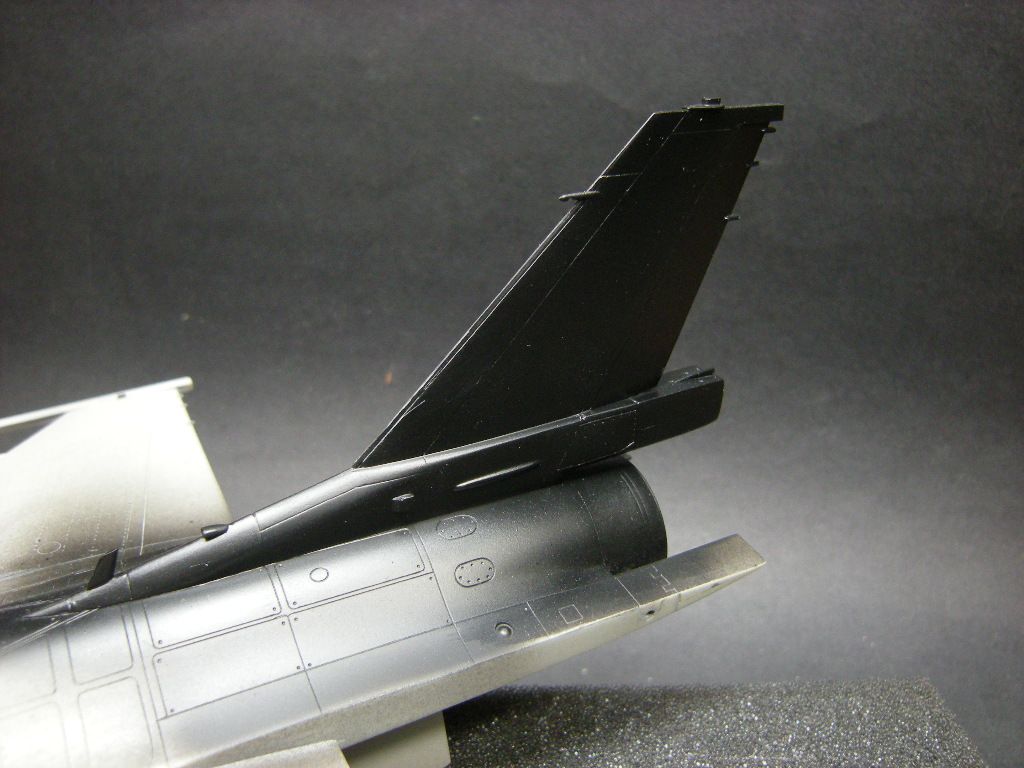

Pappy Posted June 26, 2017 Author Share Posted June 26, 2017 A little more progress on this one, cheers, Pappy Link to comment Share on other sites More sharing options...
Avgas Posted June 26, 2017 Share Posted June 26, 2017 Nice work so far Pappy. I like the Hasegawa kits too for their simplicity. I'm always eager to get to the painting stage so these kits are ideal for that. When I am brave enough to start hacking at my kits I'll be back here for some pointers! Link to comment Share on other sites More sharing options...
