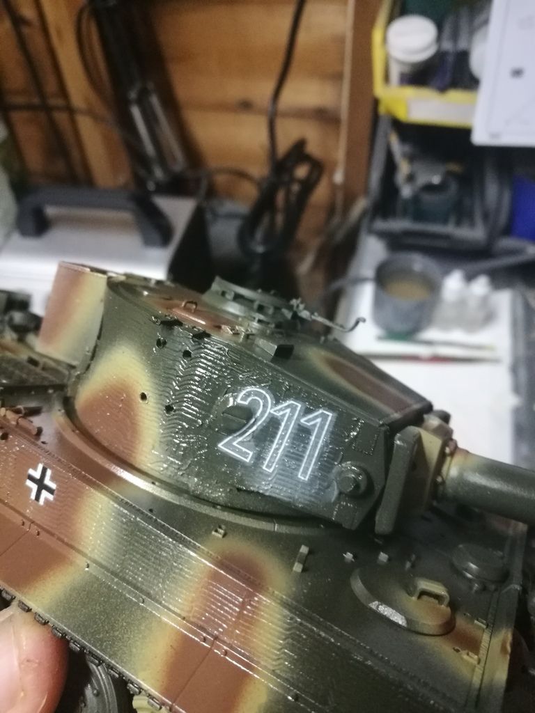

Jusjay Posted October 26, 2016 Share Posted October 26, 2016 Just for compared,this is befoe with the residue And after the hairdryer and leaving overnight Link to comment Share on other sites More sharing options...
walkerccw Posted October 26, 2016 Author Share Posted October 26, 2016 Yep, that is what mine looked like. I just had a thought about about my problem. After the decals, I put on a coat of Testors Flat Clear Coat. It is very thick compared to Future. Maybe I should put Future on again then the Flat Coat? Curt Link to comment Share on other sites More sharing options...
Jusjay Posted October 26, 2016 Share Posted October 26, 2016 Maybe I'd allow the future to cure fully before using the sol or set then another coat after that's fully cured before the flat coat but before the flat coat if it happens again try the hairdryer trick and see if it works. Just don't get it on the hottest setting or too close for too long Link to comment Share on other sites More sharing options...
