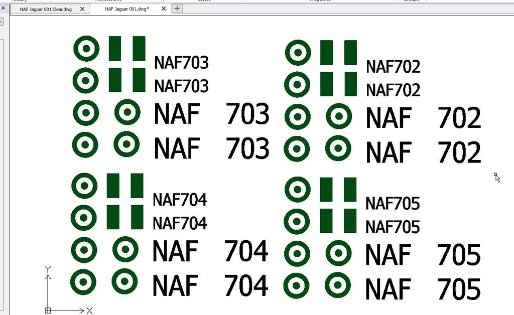

RMP2 Posted June 21, 2016 Author Share Posted June 21, 2016 Thanks to Hendies help I have managed to get this far - Thanks to a "borrowed" printer from work I have prints on clear and white sheets to play with. Yay. Just read the instructions on the Microscale Liquid Decal film though.... it says to apply to decal sheet both before AND after printing.... is that really the case or will it work ok if just sprayed over the print? Any advice on number of coats? Im thinking maybe 3 light ones, leaving to dry in between? Link to comment Share on other sites More sharing options...
hendie Posted June 23, 2016 Share Posted June 23, 2016 I only used a sealer (decal film) after I had printed - I waited a few days before sealing the decals. I took a chance and (if I remember correctly) I only did two light coats (thinned with acetone). Very light coats though as the acetone will make the ink run. The first time I did my own decals I brushed the sealer over the sheet and it was way too thick for my liking. You could just print off a couple of sheets and give the 1st sheet one light coat, 2nd sheet two light coats etc. - then see which works best for you. Nothing to lose but a sheet or two - or even just use one sheet and mask as you go The biggest problem I found was getting the best print settings - I found that what worked good for graphics didn't necessarily work great for text - I may even have used a word processor for the text - it was so long ago I can't remember. 1 Link to comment Share on other sites More sharing options...
