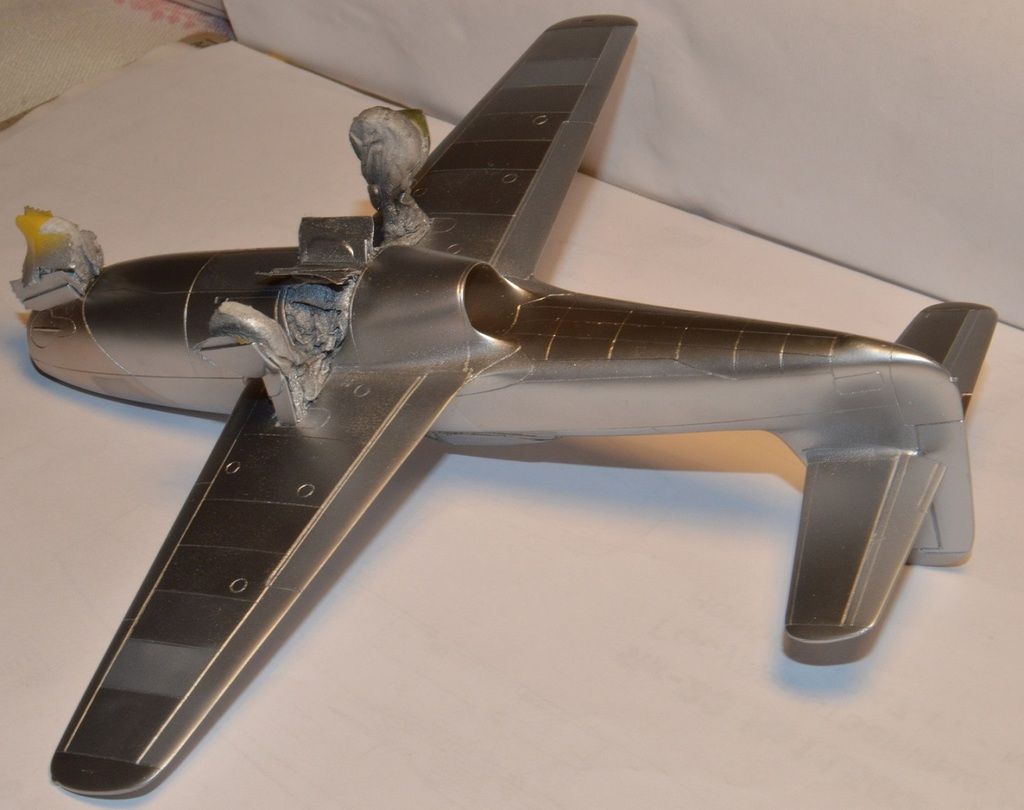

Ok so moving slowly ahead with this one... having fun with metallic paints...
Now, this is a first for me, I never used any metallic paints. Therefore, I studied a little bit the issue, before choosing a certain brand of metallic pants.
After asking, reading and watching a lot of reviews and tutorials, I choose the Xtreme range from AK Interactive, because it is (supposedly) more resistant  (than the Alclads) and more lenient with the beginners.
After using these paints, my ascertainments are:
- AK more forgiving (than the alclads) with the beginners? - maybe...difficult to say...never used alclads...
- AK highly resistant metallic pant? - NO WAY!

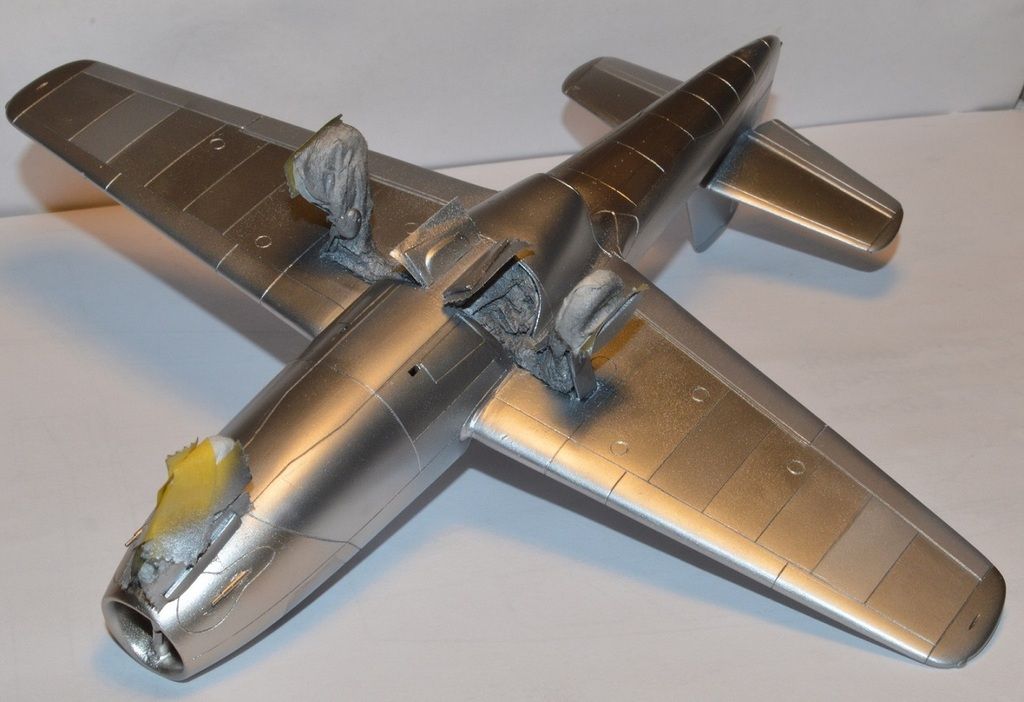

First of all, I cleaned the entire model and afterwards touched it only with gloves.
Then, I primed it with the AK Interactive dedicated primer (black base).
Then I applied the first coat over the entire model, using matte aluminum.
I waited for 24 hours and I applied tamyia masking tape in order to paint the nose with duraluminium shade. The masking tape was first applied on skin, in order to reduce its adherence.
I applied the dural on the nose and while un-masking, the original layer or matt aluminum lifted in 3 separate places. In one case the primer came off also!
Of course, I sanded, cleaned and repainted the areas...but I was very disappointed, because they claimed that you can even apply these paints without priming - they are very resistant and you can use masking tape on them without any worries. Well, not so true, I guess.
Anyway, after this setback I gave up using tamyia tape for masking and started using post-it notes....after 48 hours since the first coat, a post-it lifted paint from one of the horizontal stabilizers...
Now, I might be inexperienced with metallic paints...but they are advertising this brand as being more resistant than other metallic paints when using masking tape. Judging on how AK behaved in my case, I guess that other (less resistant or less forgiving) metallic paints should peel off only when you look at them...so I am inclined to believe that the advertising was somehow over-optimistic:)

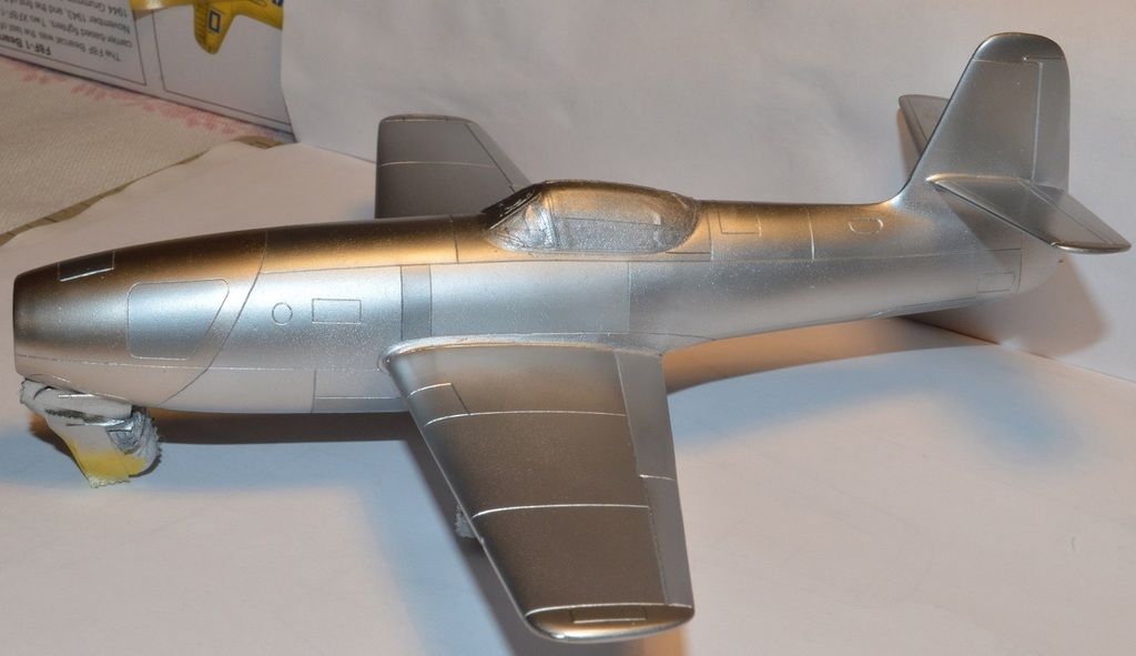

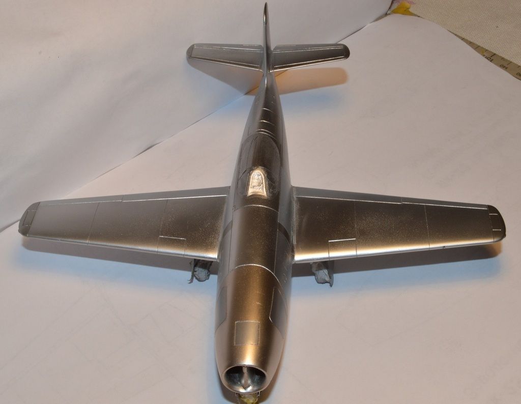

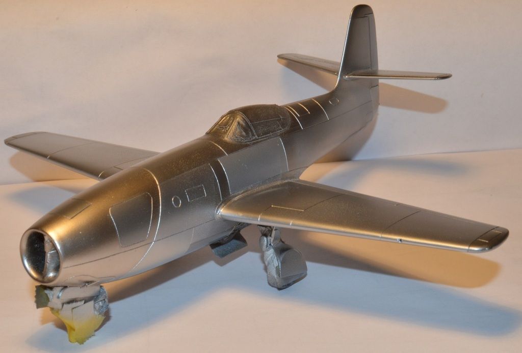

However, despite these setbacks, this is how it looks now.
Until now, I used shades of matt aluminum, dark aluminum, white aluminum, aluminum, duraluminum and steel. No protective gloss coat used yet.
I still want to add some dark aluminum on some panels on the wings, in order to increase the contrast in that area...and also on the various removable panels&stuff.

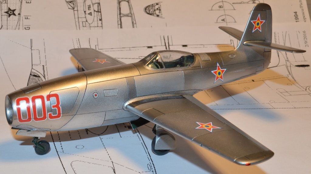

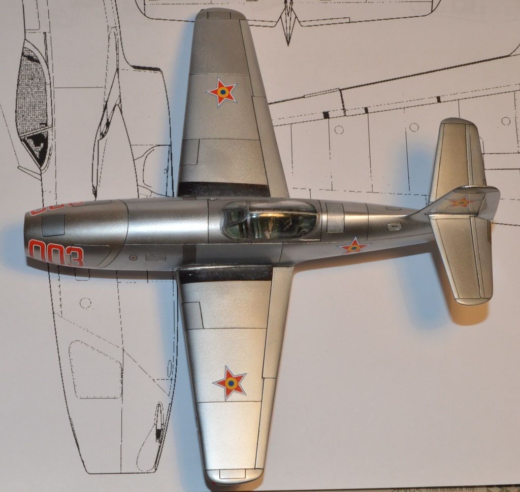

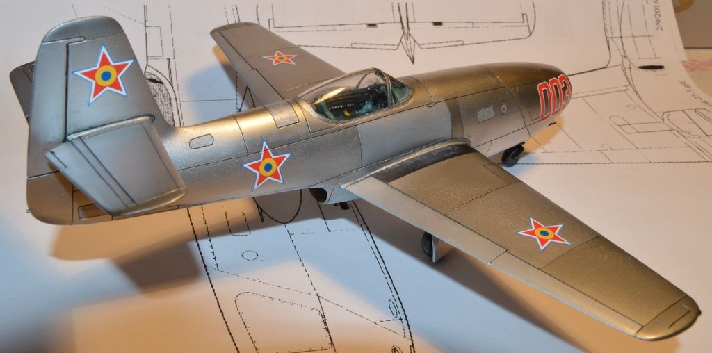

I gave it a coat of tamyia X22 diluted with leveling thinner (Mr.color).
Although this took away some of the metallic shine, my impression is that is not so bad as I read in some reviews.
The soviet aluminum was indeed more duller that the highly polished American bare-metal machines.

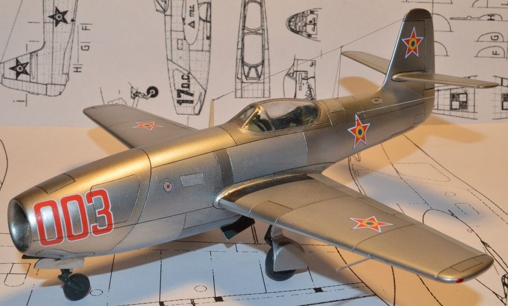

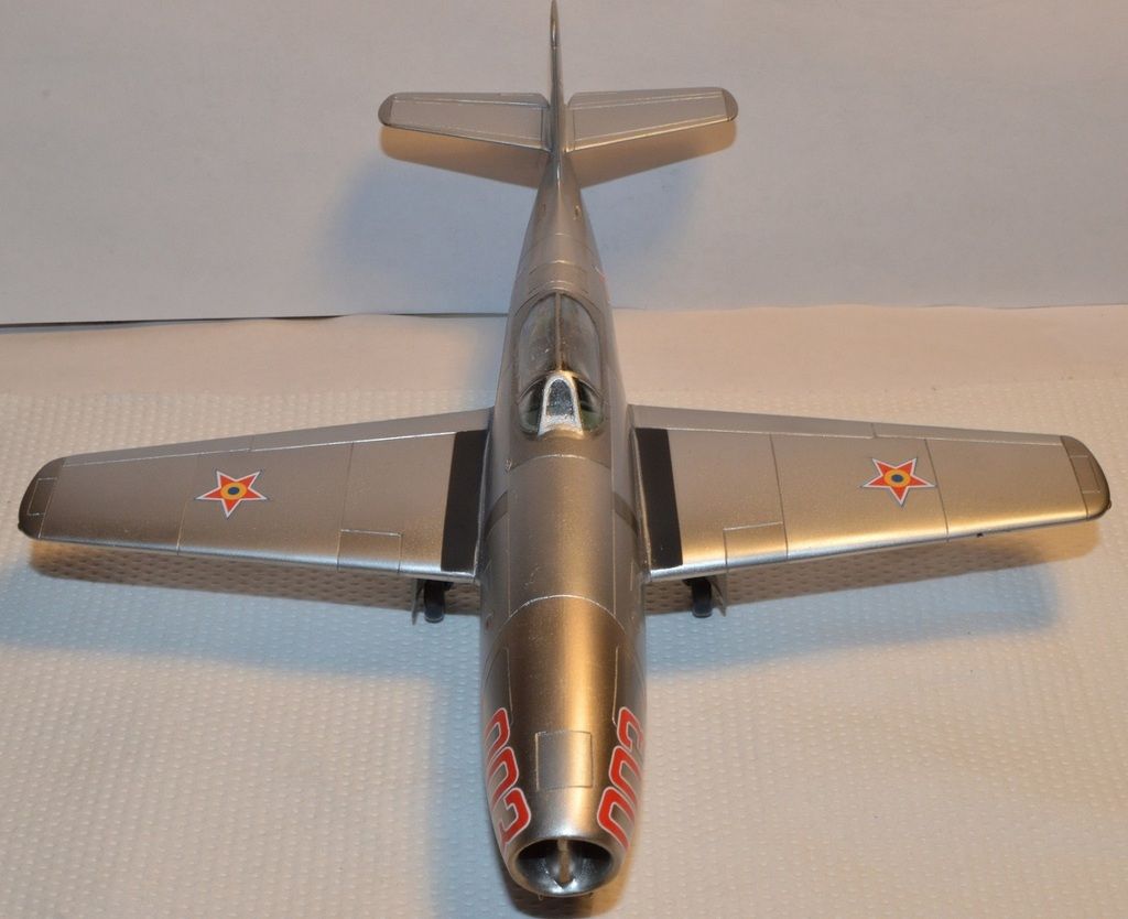

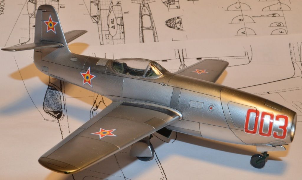

After the gloss coat cured, I put the decals.
It will be a Romanian registration - 135 Fighter Regiment, during the fifties'.
The Romanian decals were acquired separately, because OOB you can make only a Czech, Polish or soviet registration. And an American one, belonging to a captured machine which was evaluated in the US.
After buying the 1/48 Romanian communist registrations (the tri-color stars with registration numbers), I noticed that the stars were designed for the Mig family of aircraft - which are obviously bigger machines than the little Yak. Using the 1/48 stars was out of the question...so I bought also the 1/72 version of the same decal sheet.

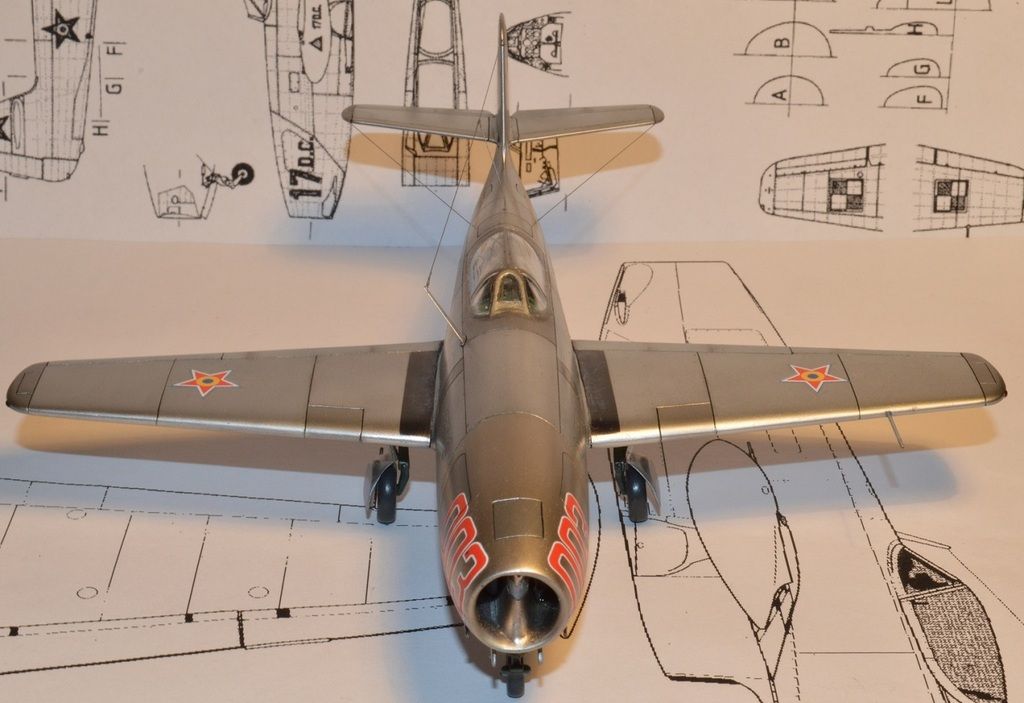

In the end, I used the 1/72 stars combined with the 1/48 registration numbers (on the nose). It's a satisfactory compromise...I used as an inspiration the aircraft the attached picture from 1950-55.
So this is where I am now.
Soon I hope I can give it another gloss coat over the decals, then some minor weathering and that's it.
I have to install the pitot tube and antenna also - but this will be done only I'm done with all the rest.

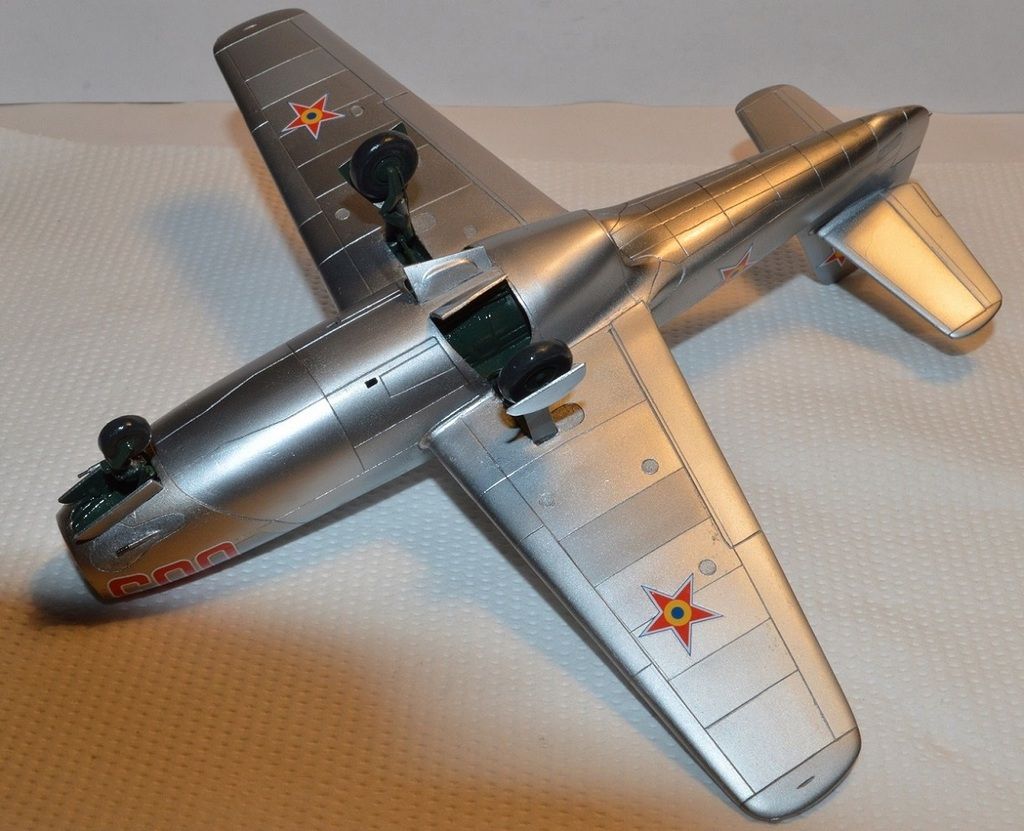

In the meantime, not much progress with the little Yak. My airbrush failed me and I have to wait until it will be repaired.
The only news is a panel lines pin wash made with oil color...I used a blue-gray shade named Payne's Grey....hope its appropriate for a NMF aircraft.
I also applied some AK dust effects on the black walkways on the wings and painted the position lights from the wingtips.
Regards and thanks for looking,
  • Like 5
