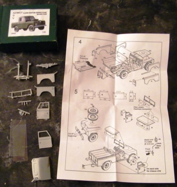

dcrfan Posted February 25, 2016 Share Posted February 25, 2016 (edited) Azimuth make a LAND ROVER SERIES II 88 HARD TOP. This is SWB cab only. See http://www.azimutproductions.comunder Armour - Azimuth Limited Edition. I have one but it arrived rather bent although it's so thin it was easy to realign with hot water. See also this thread http://www.britmodeller.com/forums/index.php?/topic/47748-135-land-rover/?hl=%2Brhodesian+%2Brailways+%2Bland I've built the same version of Rhodesian Land Rover. Very easy conversion. Edited February 25, 2016 by dcrfan Link to comment Share on other sites More sharing options...

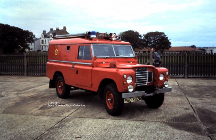

paul_c Posted February 26, 2016 Author Share Posted February 26, 2016 (edited) Thanks dcrfan, I may have been vague in my OP but I did mean a hard top rear instead of the canvas tilt it currently has. This is the type of truck I'm looking to recreate........ Edited February 26, 2016 by paul_c Link to comment Share on other sites More sharing options...
dcrfan Posted February 28, 2016 Share Posted February 28, 2016 Ah I tonight you meant something like this http://www.fire-engine-photos.com/picture/number4265 Link to comment Share on other sites More sharing options...
