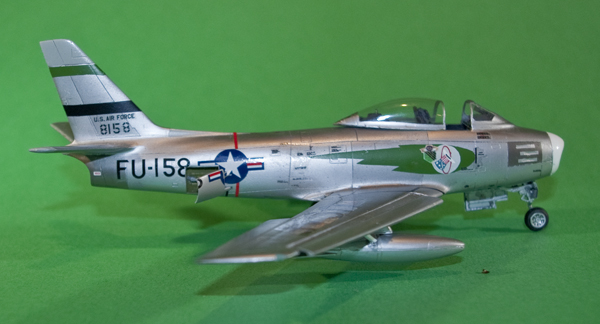

ejboyd5 Posted February 10, 2016 Share Posted February 10, 2016 Wez mentioned the old Modeldecal sheet so I thought I'd supply some pictures as applied to the Matchbox kit: 3 Link to comment Share on other sites More sharing options...
Wez Posted February 10, 2016 Share Posted February 10, 2016 Wez mentioned the old Modeldecal sheet so I thought I'd supply some pictures as applied to the Matchbox kit: That is a lovely Sabre, nice one! Link to comment Share on other sites More sharing options...

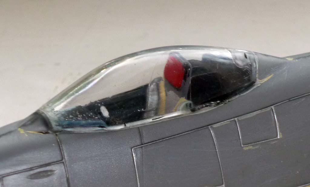

John R Posted May 20, 2016 Author Share Posted May 20, 2016 (edited) This might be of interest to anybody unhappy with the shape of the Matchbox F86A canopy. Taking the canopy for the Matchbox F86A pictured in my earlier thread I decided, before removing it amd replacing it with the Heller version, to see if it could be modified so I took a sanding block and ground it to the 'correct' shape with a rounded front section. I managed to remove enough of the top without going through to the inside. I then polished it and achieved the following result. There appears to be a hairline crack, just visible in front of the seat. Whether this was pre-existing or caused by my ham fisted modification I do not know but it does appear that a lot can be done with the Matchbox canopy. John Edited May 20, 2016 by John R Link to comment Share on other sites More sharing options...
Tony Edmundson Posted May 20, 2016 Share Posted May 20, 2016 interesting way of dealing with the fictional framing and Vee shape. There's still that ridiculous separate rear section and bogus area behind the seat to put up with though. Let's see it after you have put on all the canopy framing, please. Tony 1 Link to comment Share on other sites More sharing options...
John R Posted May 21, 2016 Author Share Posted May 21, 2016 It was not intended to be used as it would have to removed and cleaned up internally and I did not rate the chance of a successful removal very highly . I have a Heller canopy to modify as the 'real thing' and so I decided to see if it was possible to reshape a canopy. Please can you clarify what you meant by "There's still that ridiculous separate rear section and bogus area behind the seat to put up with though." as I have not studied the internals of the Sabre cockpit. There was also, earlier in this thread, a comment about using an F80 nosewheel. Was this instead of the Matchbox or Heller item as, again, I was unaware of any problem in this area. Thank you for all your input - I'm sure that many others besides me are finding it of great interest. Link to comment Share on other sites More sharing options...
Tony Edmundson Posted May 21, 2016 Share Posted May 21, 2016 Please can you clarify what you meant by "There's still that ridiculous separate rear section and bogus area behind the seat to put up with though." as I have not studied the internals of the Sabre cockpit. There was also, earlier in this thread, a comment about using an F80 nosewheel. Was this instead of the Matchbox or Heller item The fact that Matchbox molded part of the moveable sliding canopy as part of the fuselage, AND , that big box-like structure behind the seat is a work of someones's imagination. I used a copy of a F-80 nose wheel as it looked similar(not exact) to the early type nosewheel found in some Korean-era Sabres. The Matchbox nose wheel is a poor rendition, the Heller wheel is much superior but didn't fit my build. early wheel on McConnell's Sabre; Cheers, Tony Link to comment Share on other sites More sharing options...
