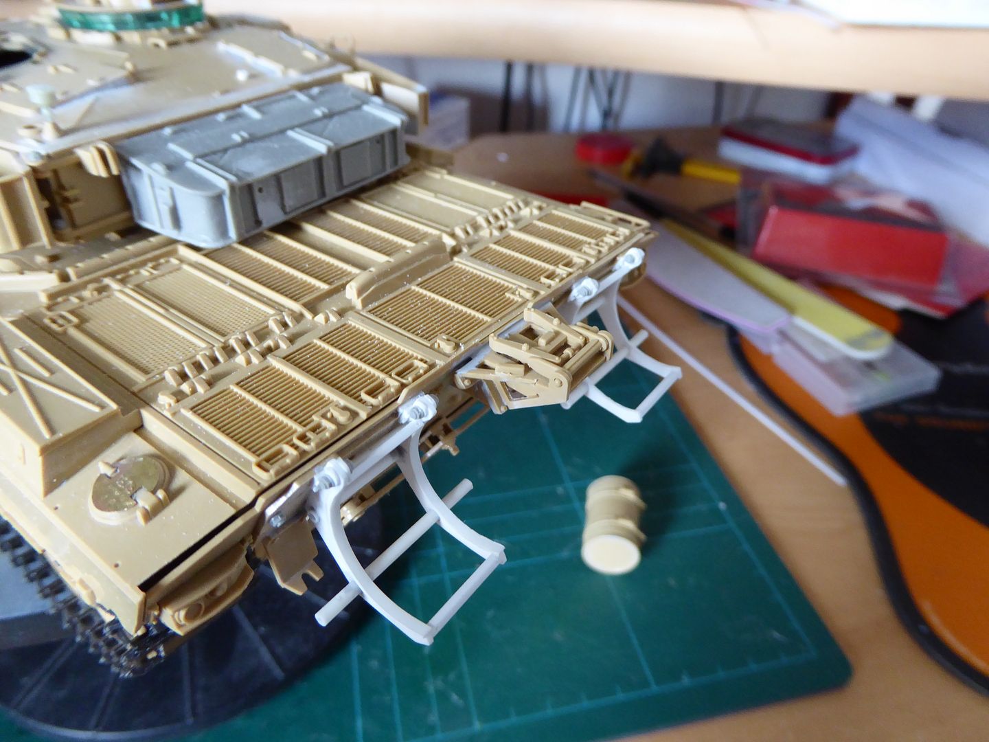

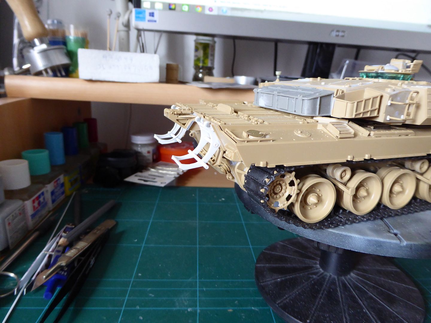

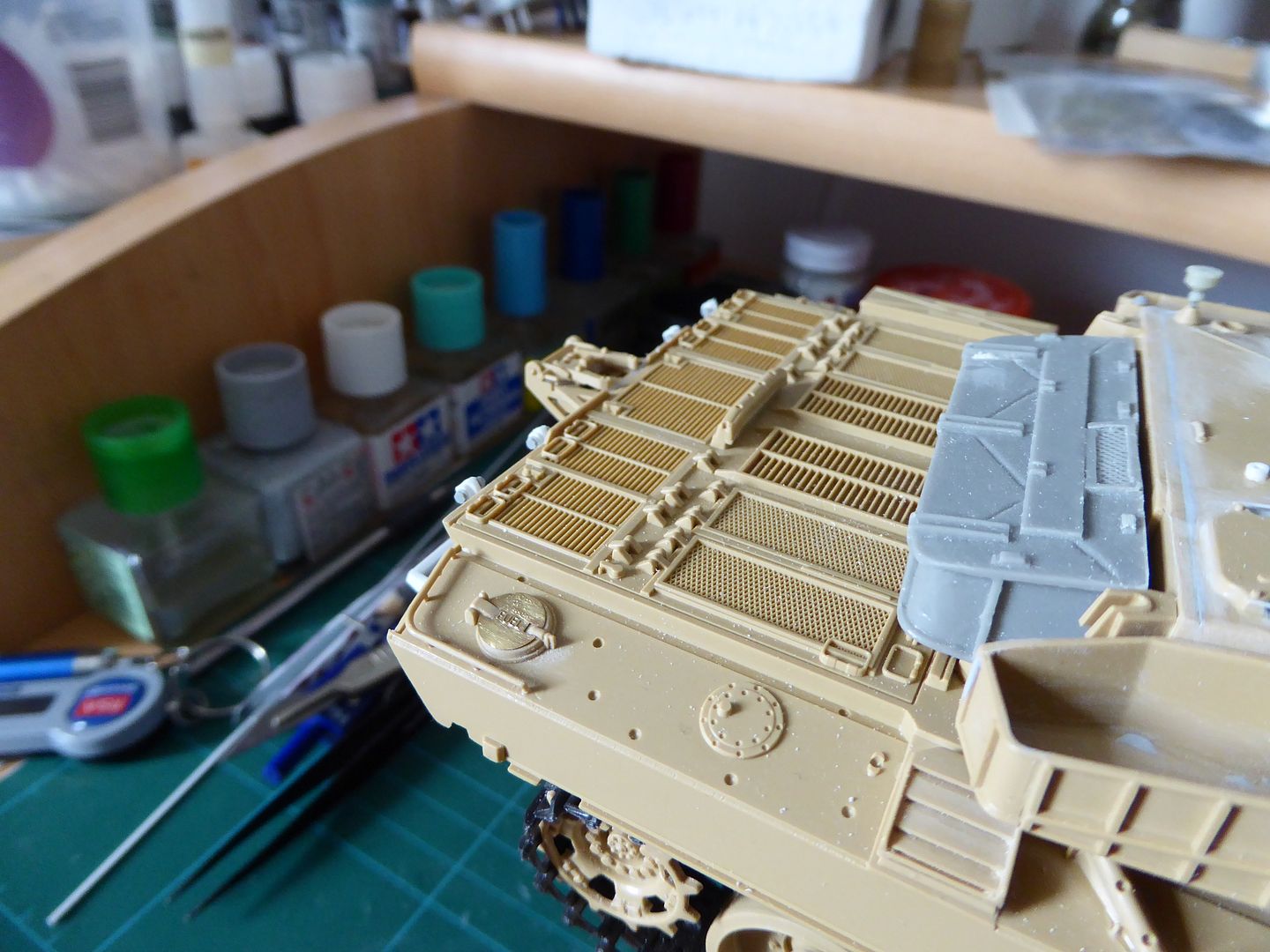

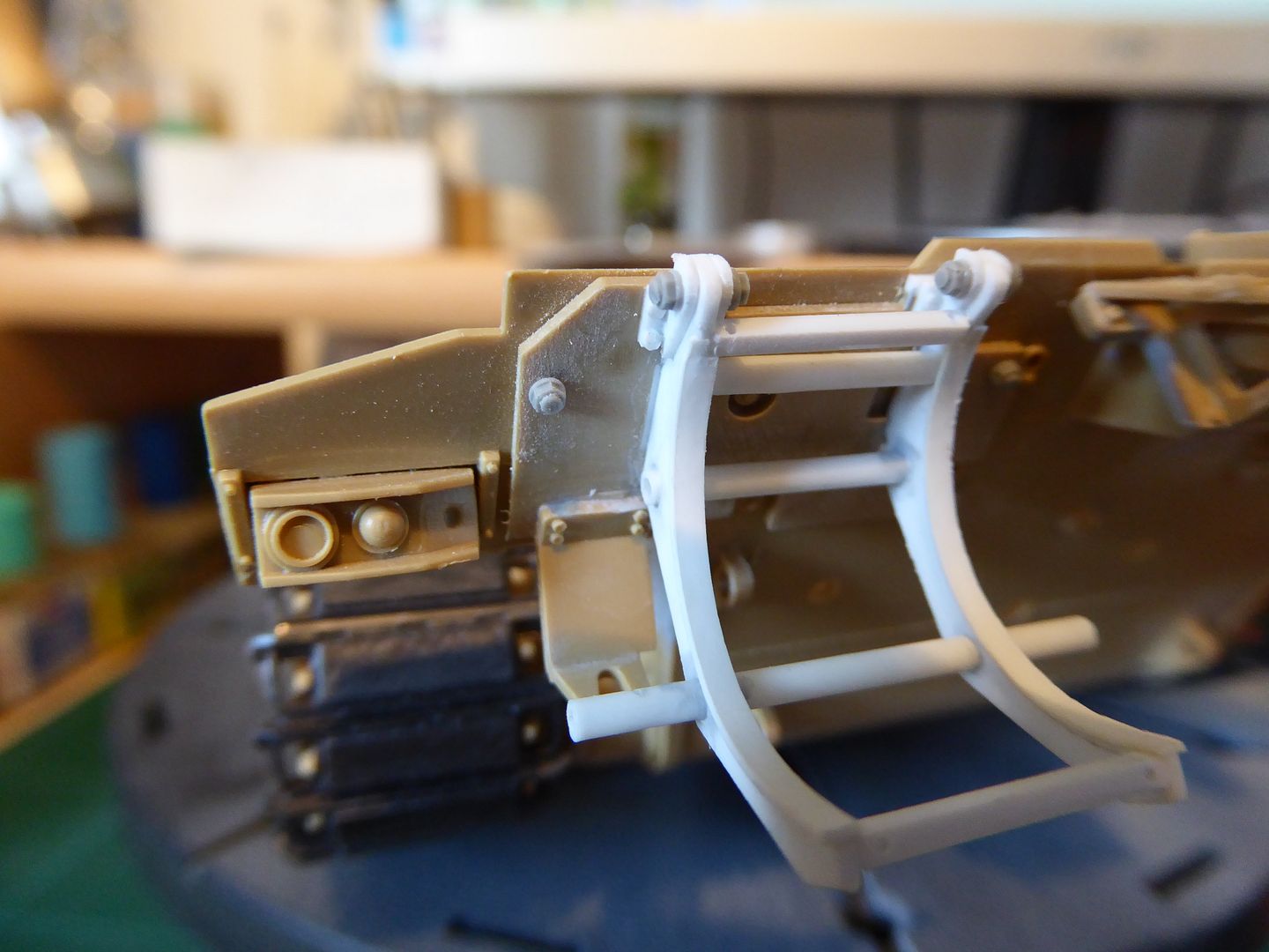

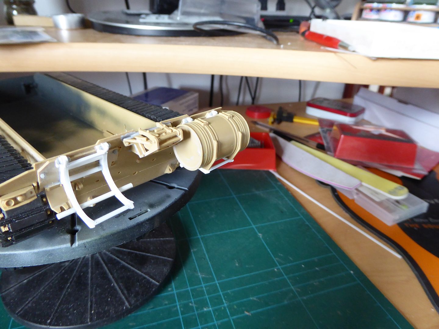

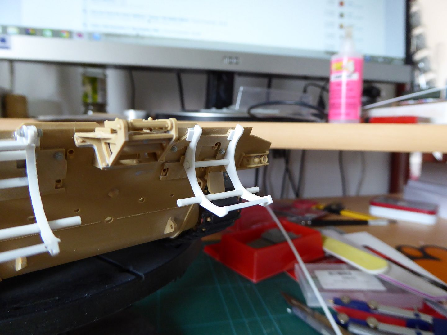

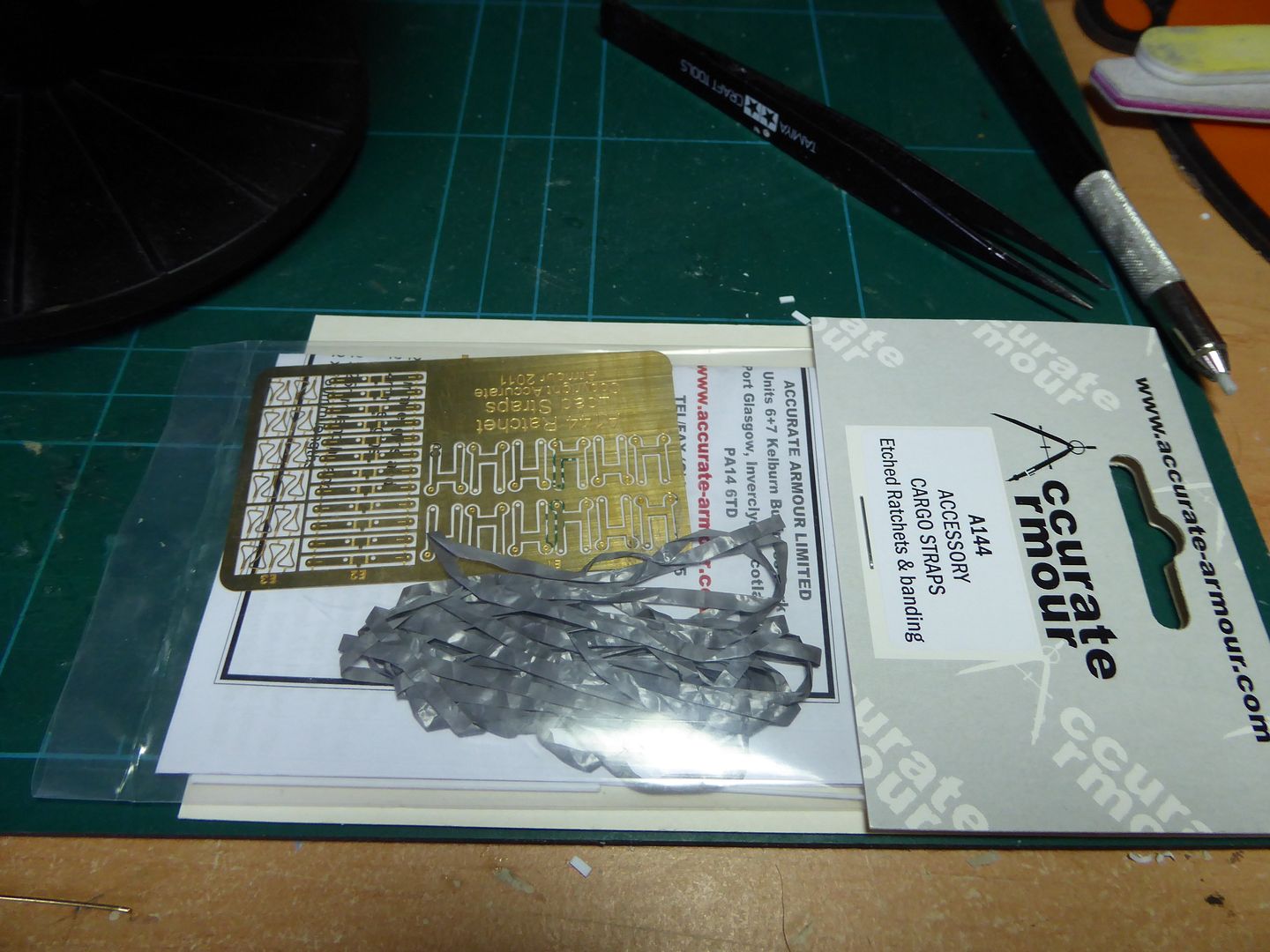

Dads203 Posted July 26, 2015 Author Share Posted July 26, 2015 Thank you chaps , So an hour at the bench today, a bit more work. Going to use these ratchet straps from Accurate Armour for the barrel straps, hopefully they are not too big. Still loads to do on the brackets so please stay tuned. Enjoy Dan 6 Link to comment Share on other sites More sharing options...

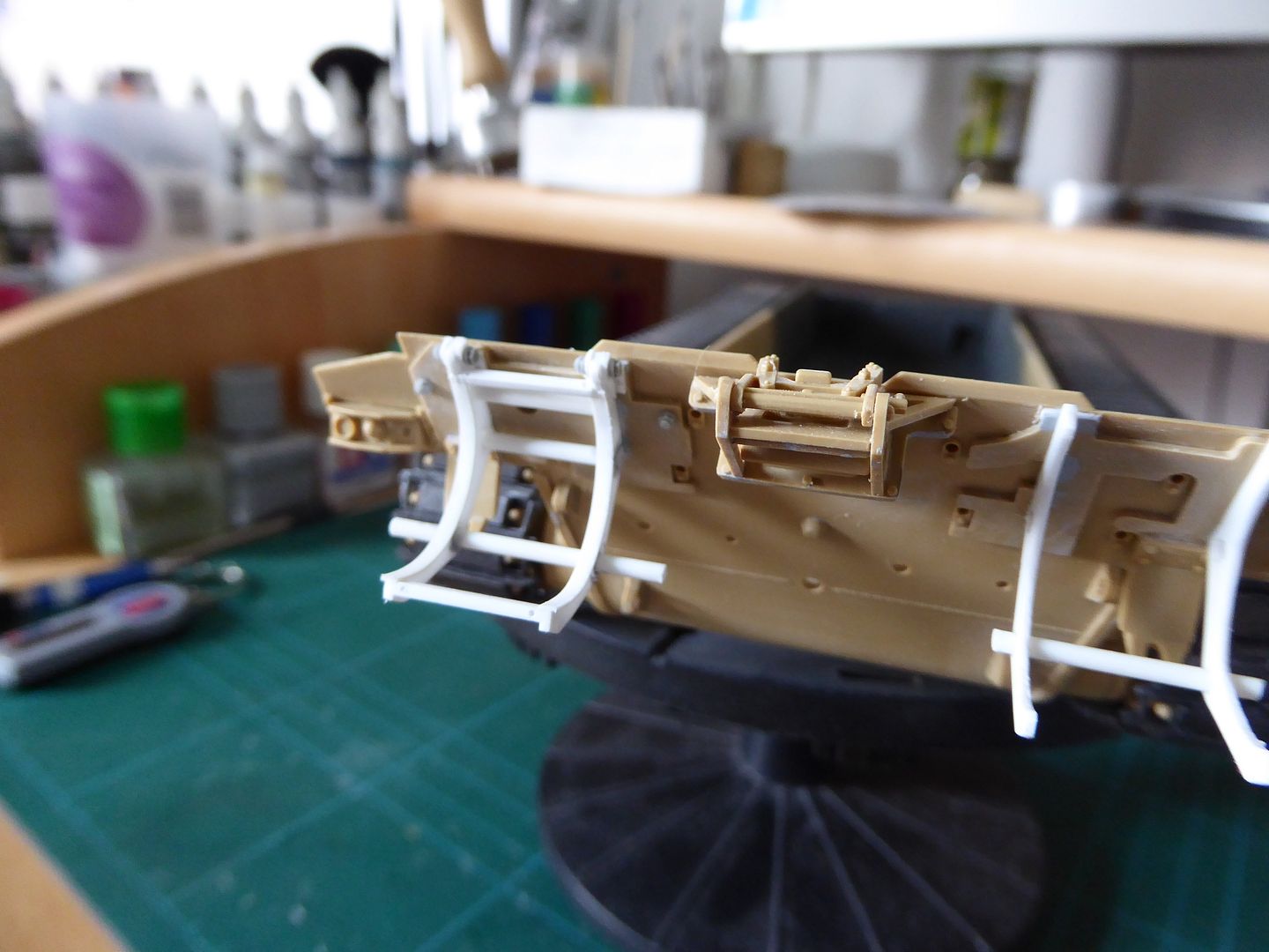

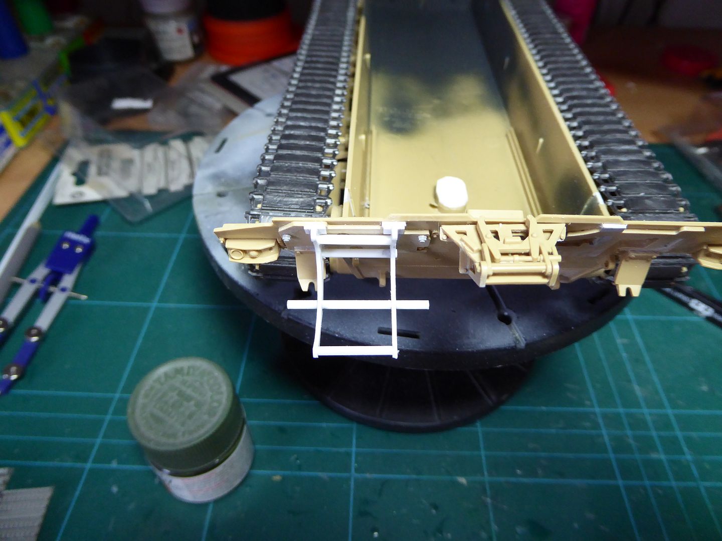

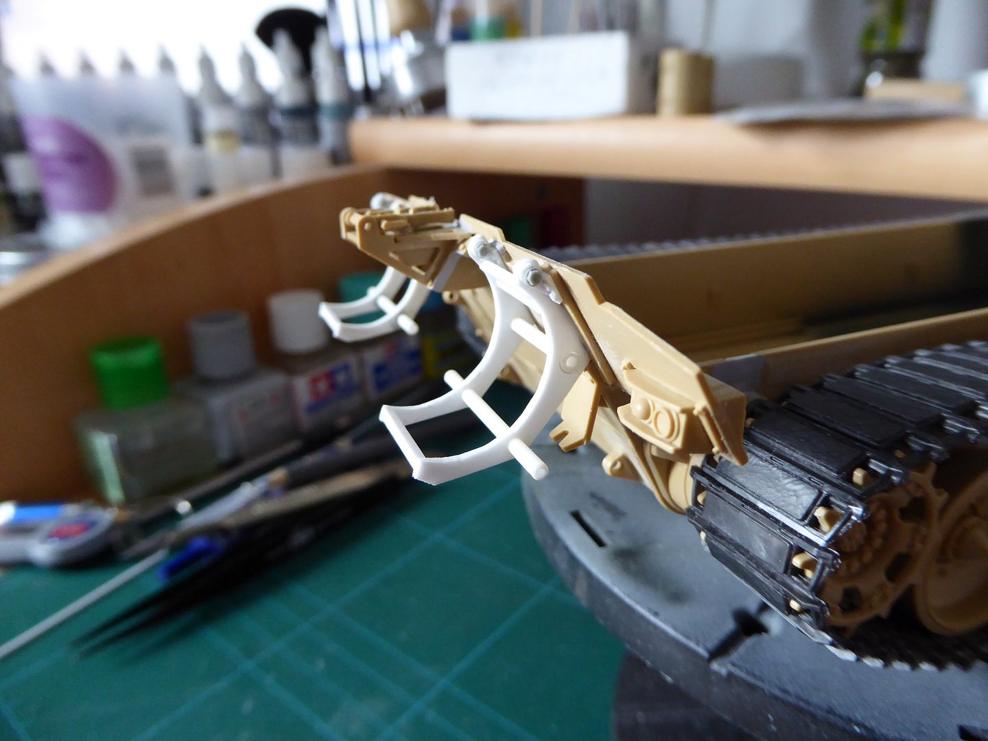

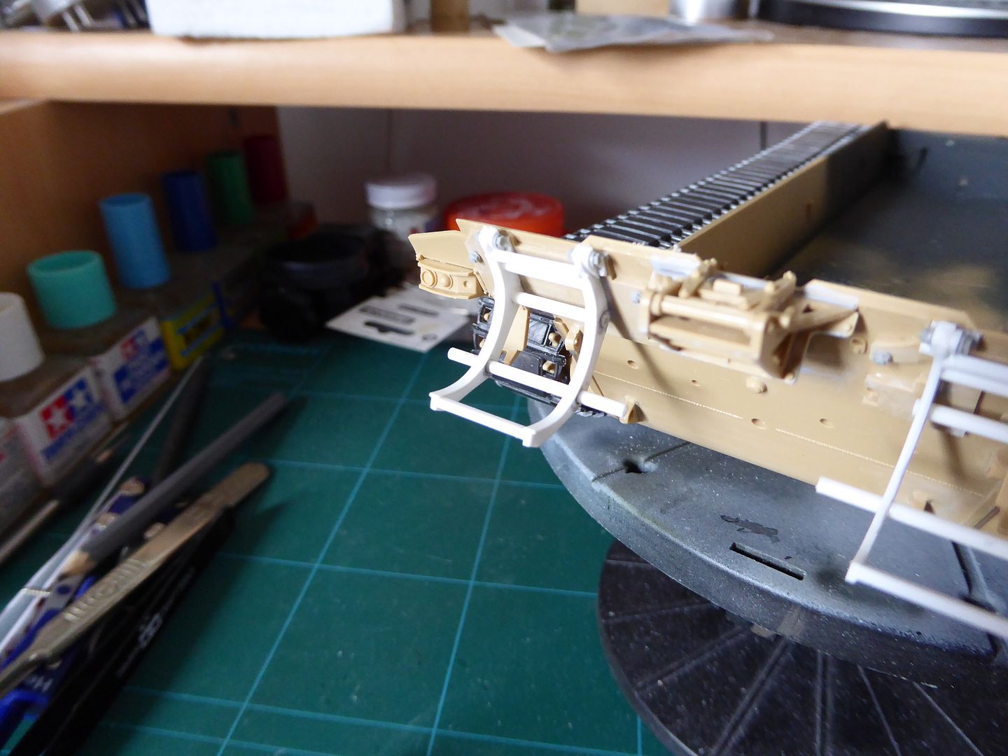

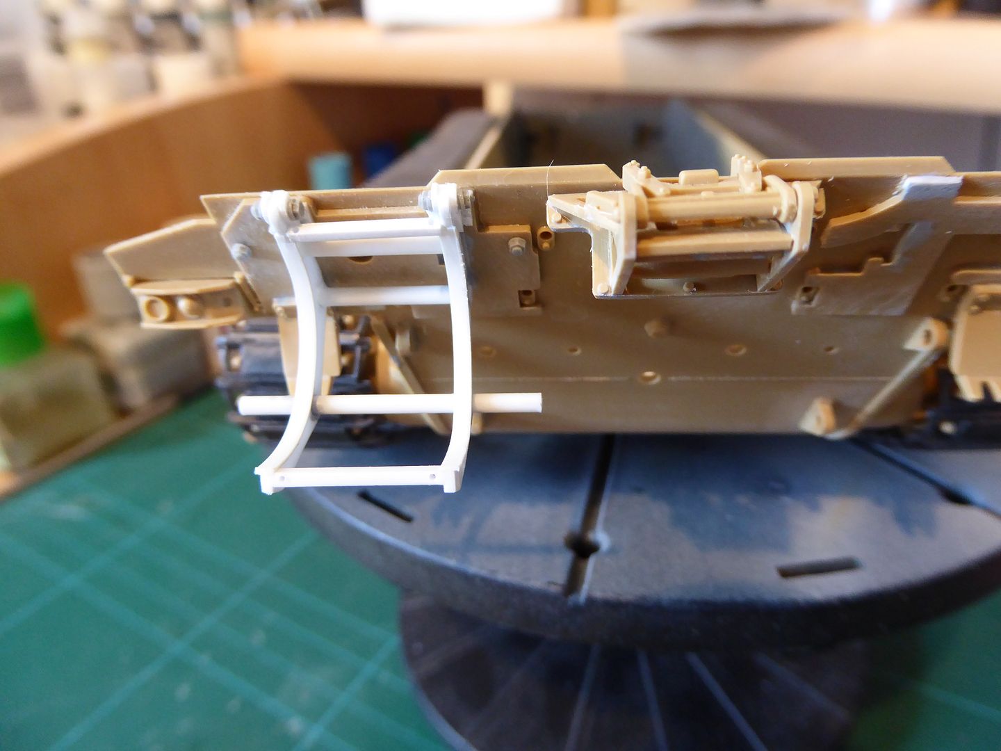

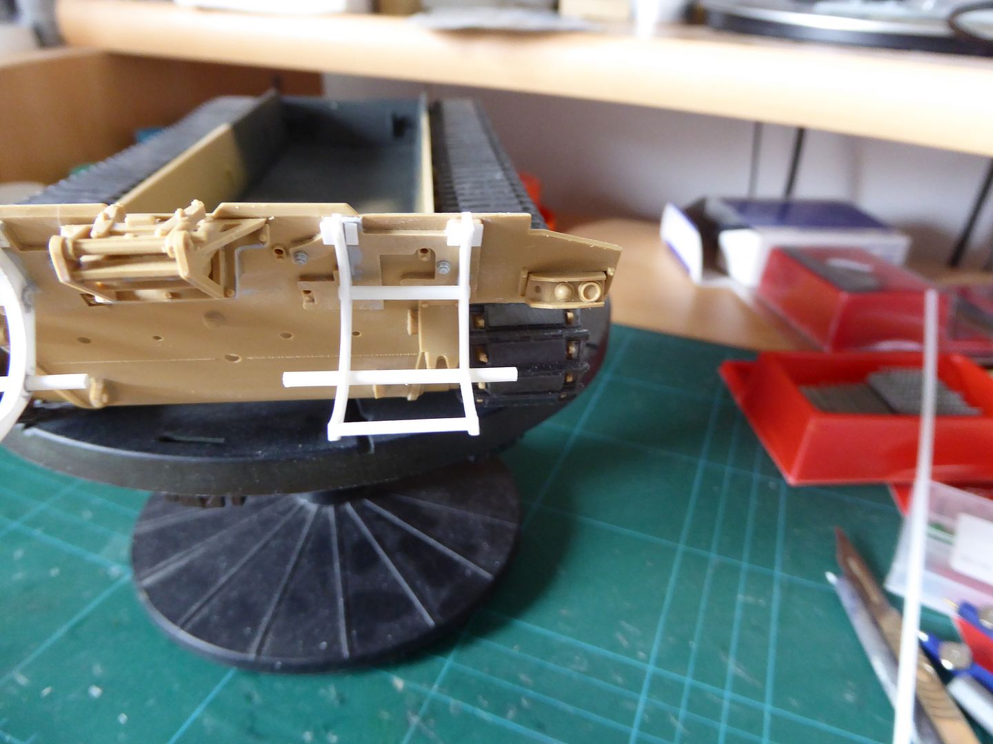

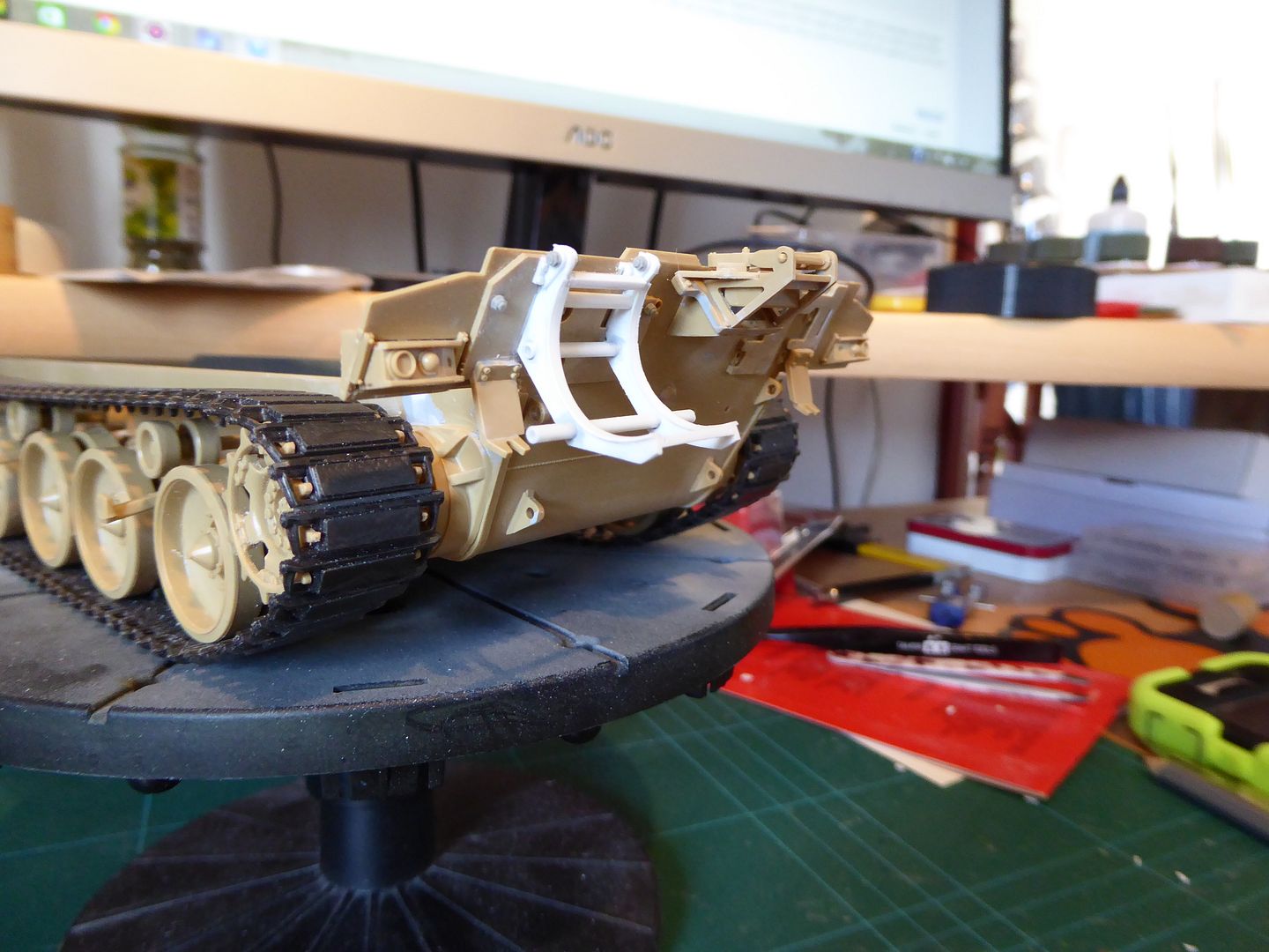

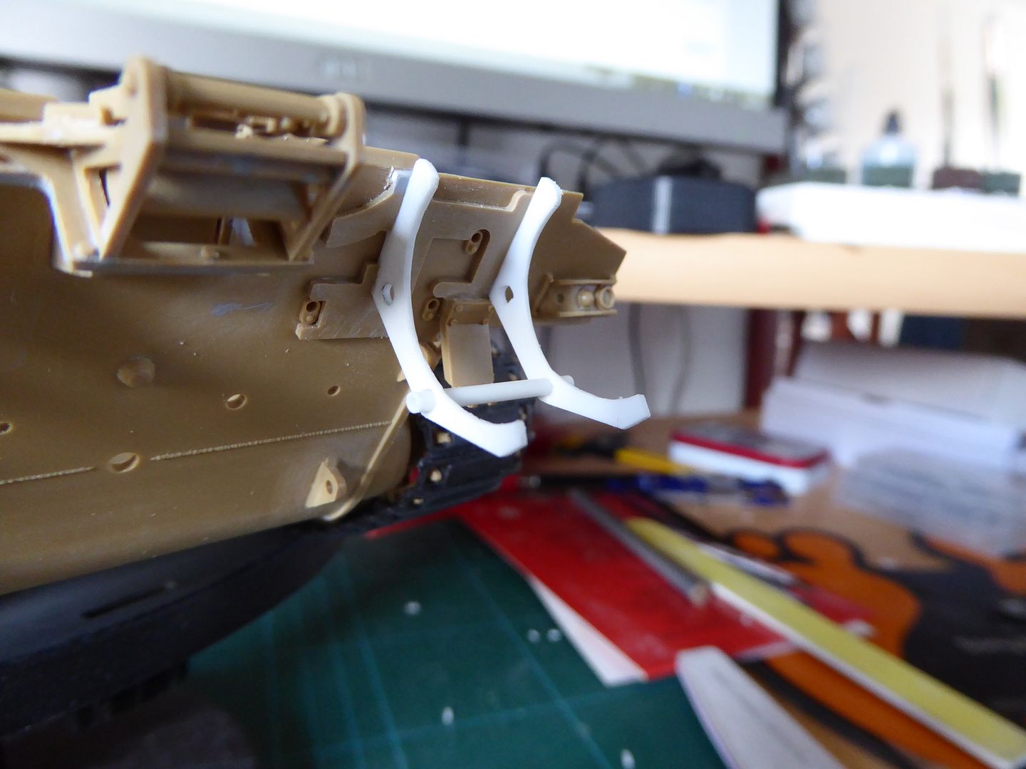

Dads203 Posted July 29, 2015 Author Share Posted July 29, 2015 A tiny bit more work done to the brackets. This one is more of a proof of concept really, making sure all the parts work and it looks right. Second set of brackets shouldn't take too long. Dan 1 Link to comment Share on other sites More sharing options...

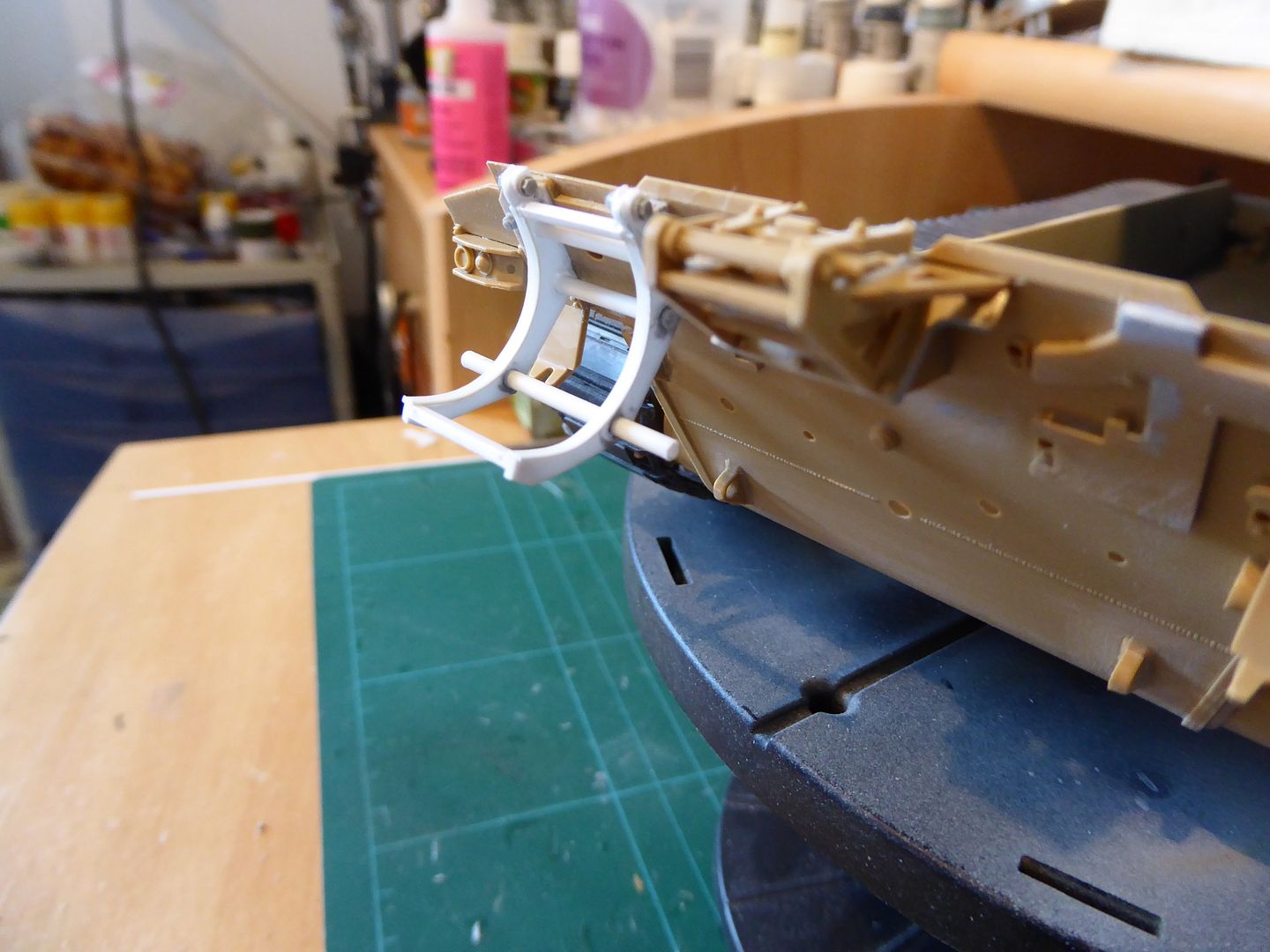

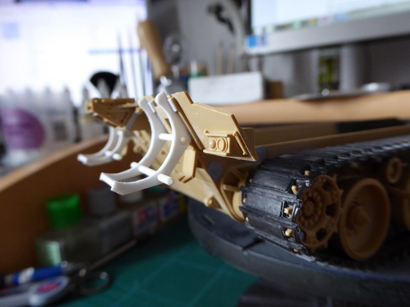

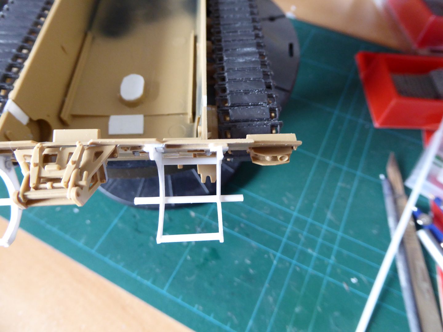

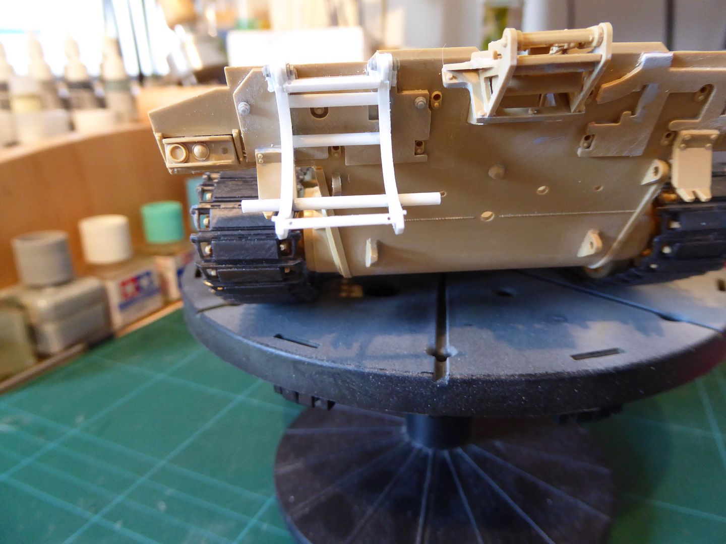

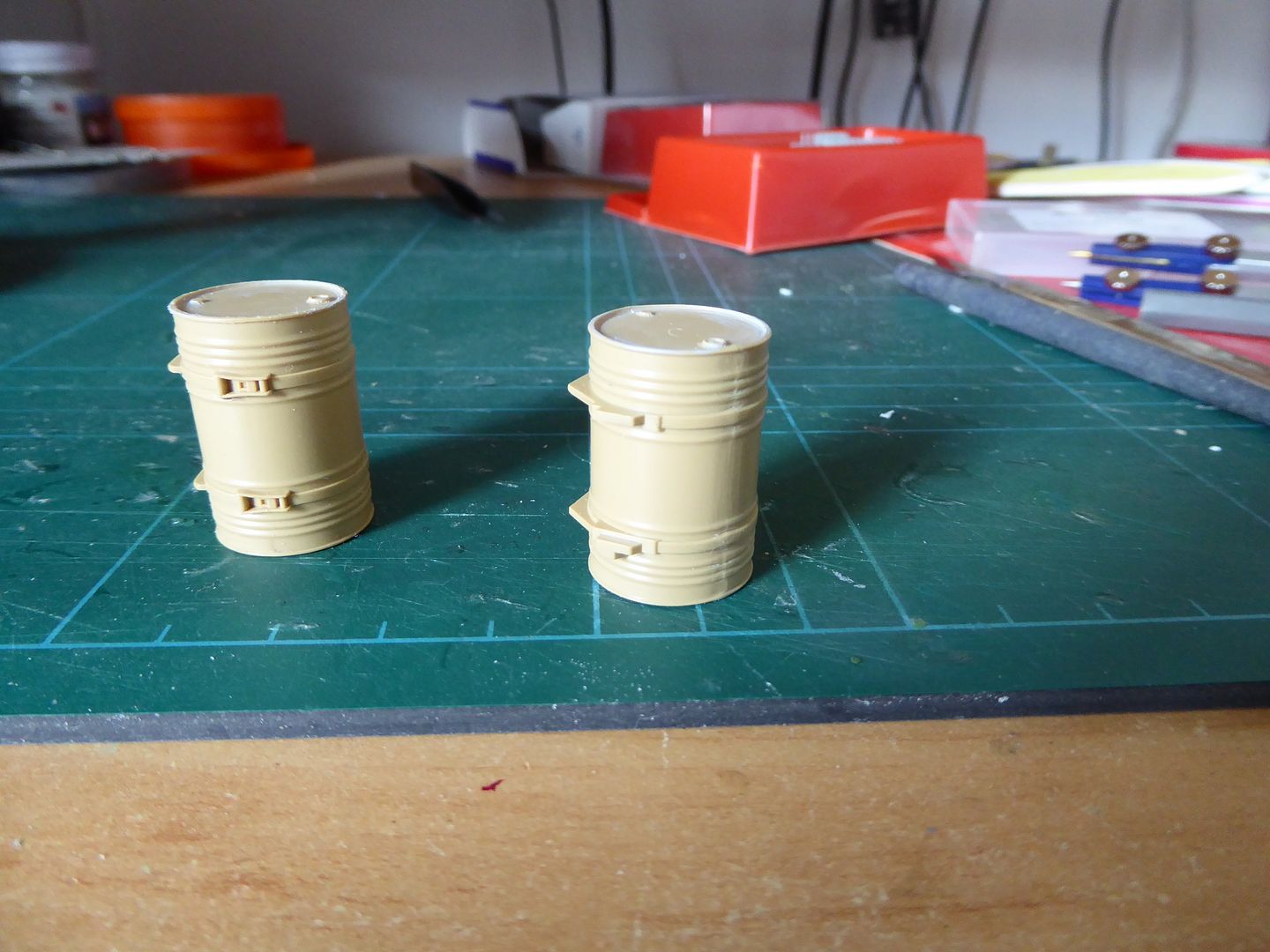

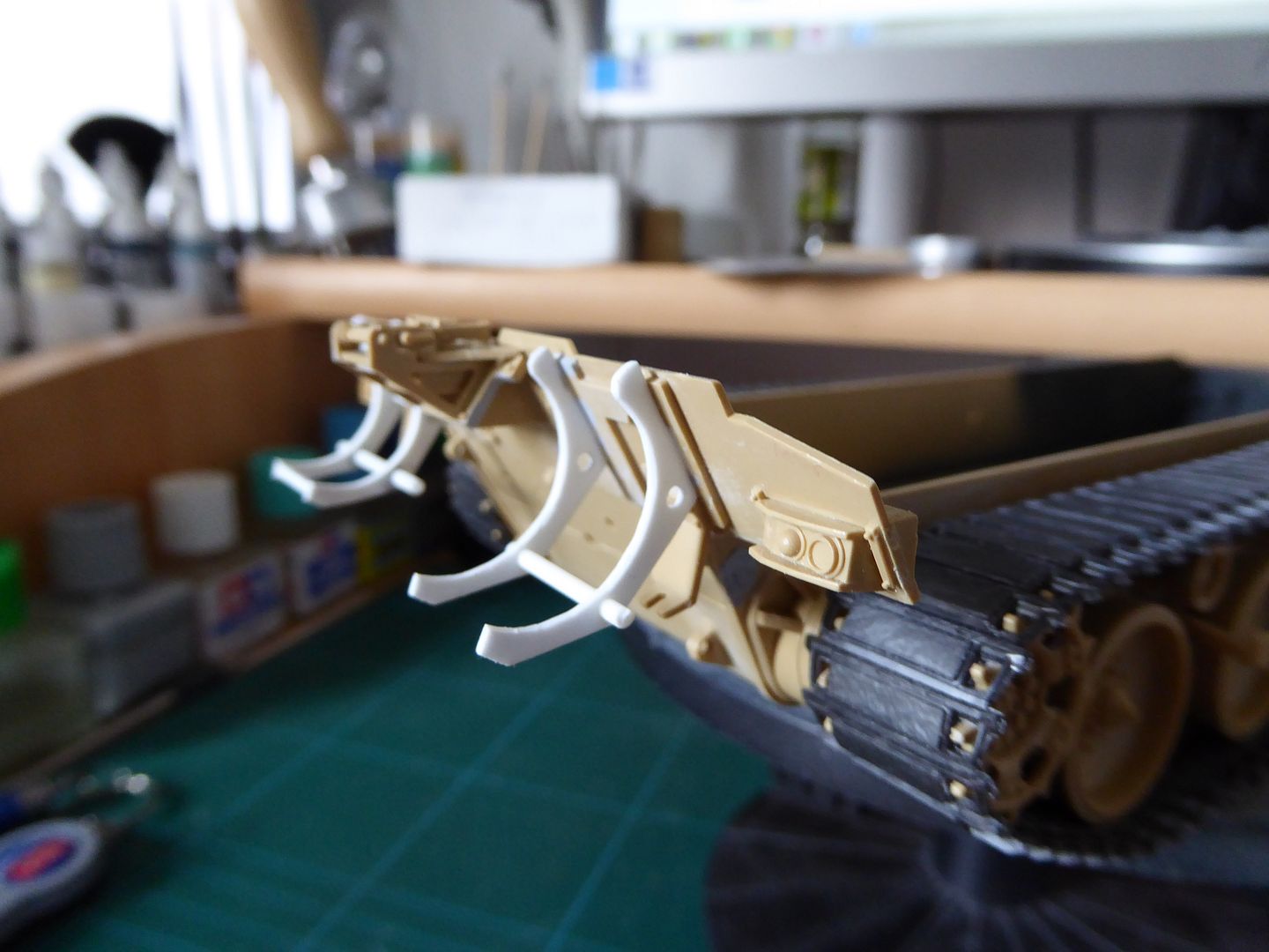

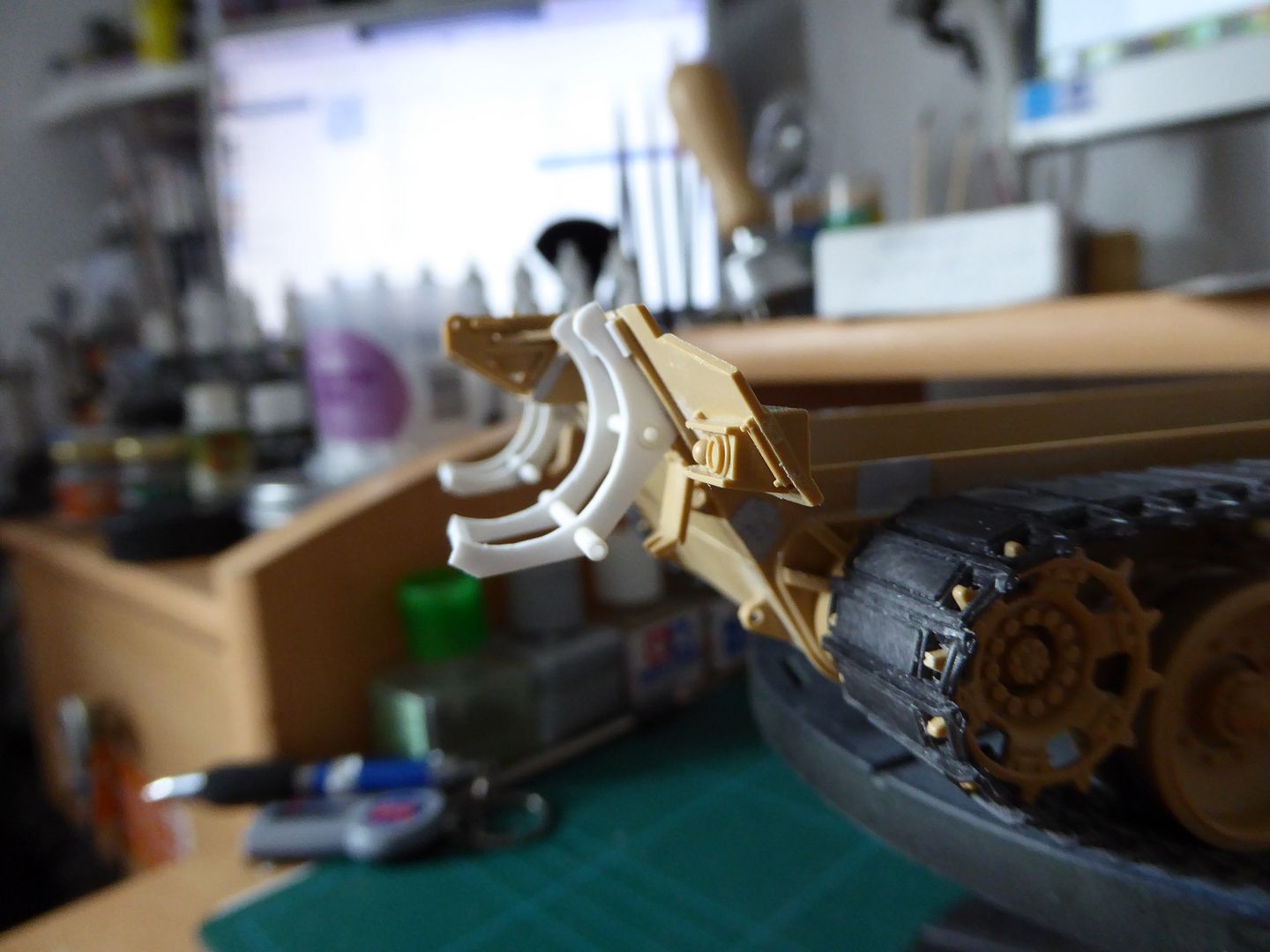

Dads203 Posted July 30, 2015 Author Share Posted July 30, 2015 Thank you chaps, started on the second set now, the short rod is just to hold it all in place and will be replaced with a longer one once all is set properly. Enjoy Dan 1 Link to comment Share on other sites More sharing options...

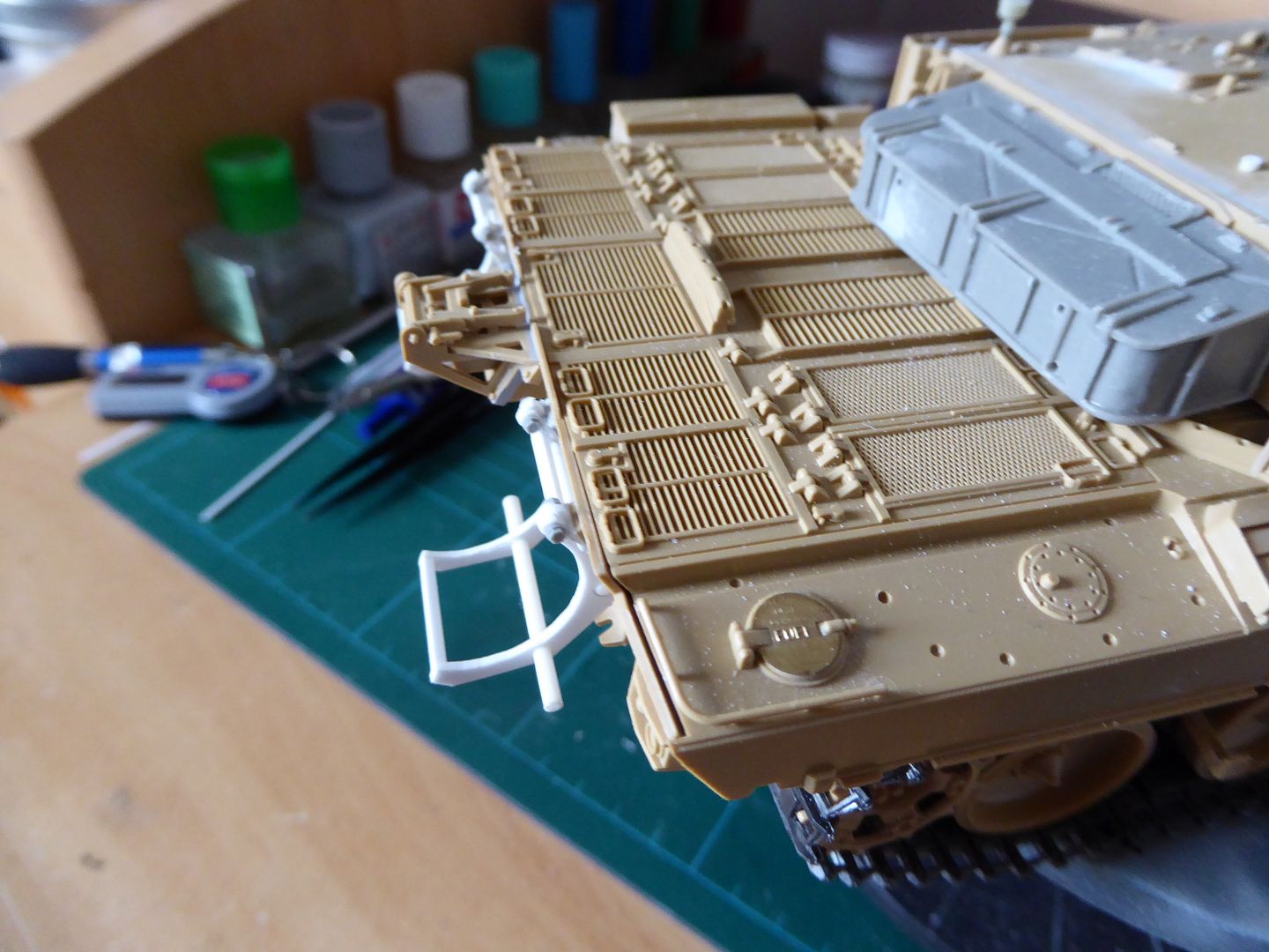

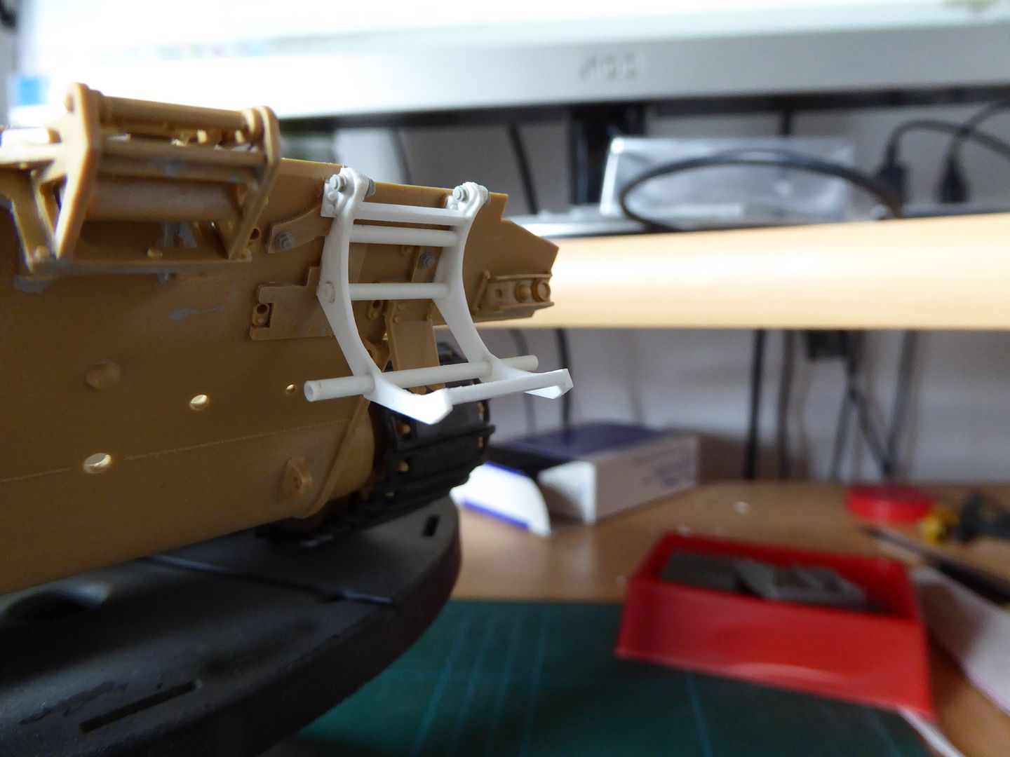

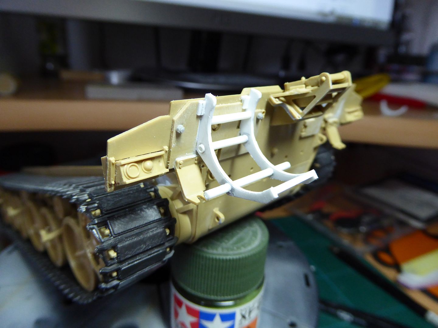

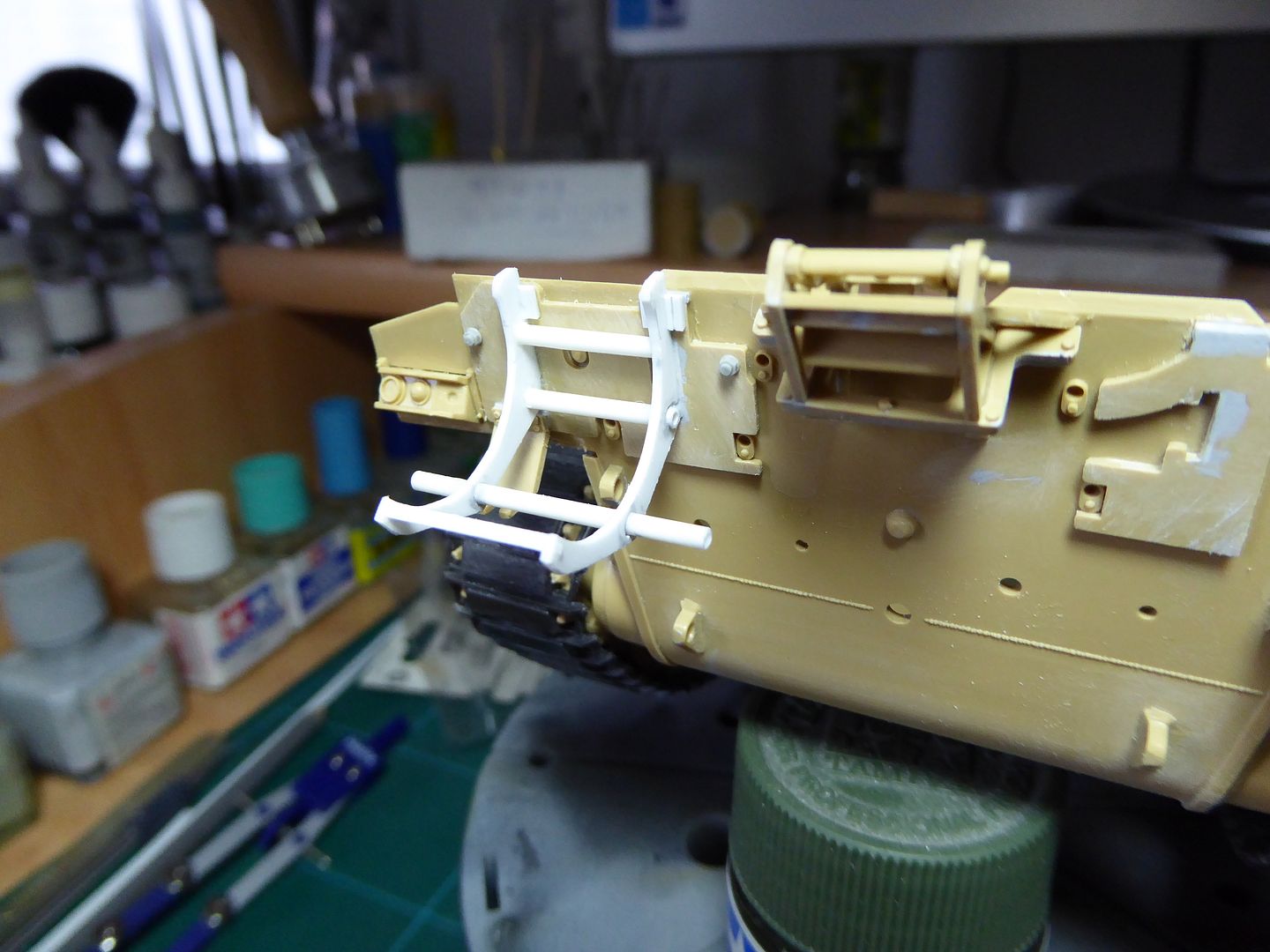

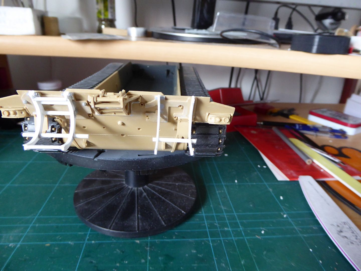

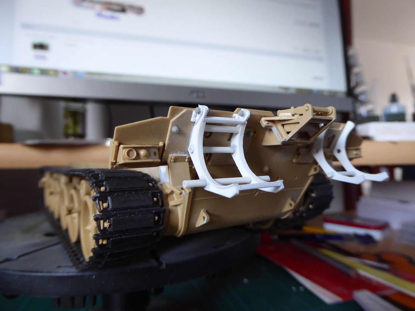

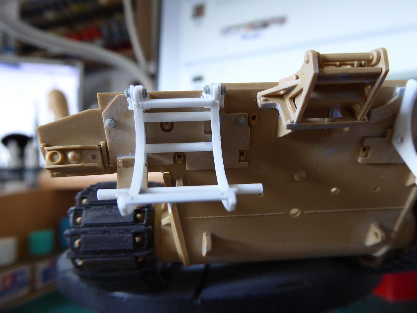

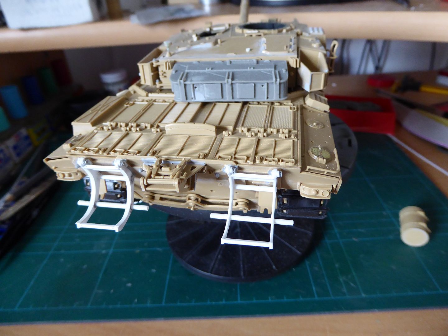

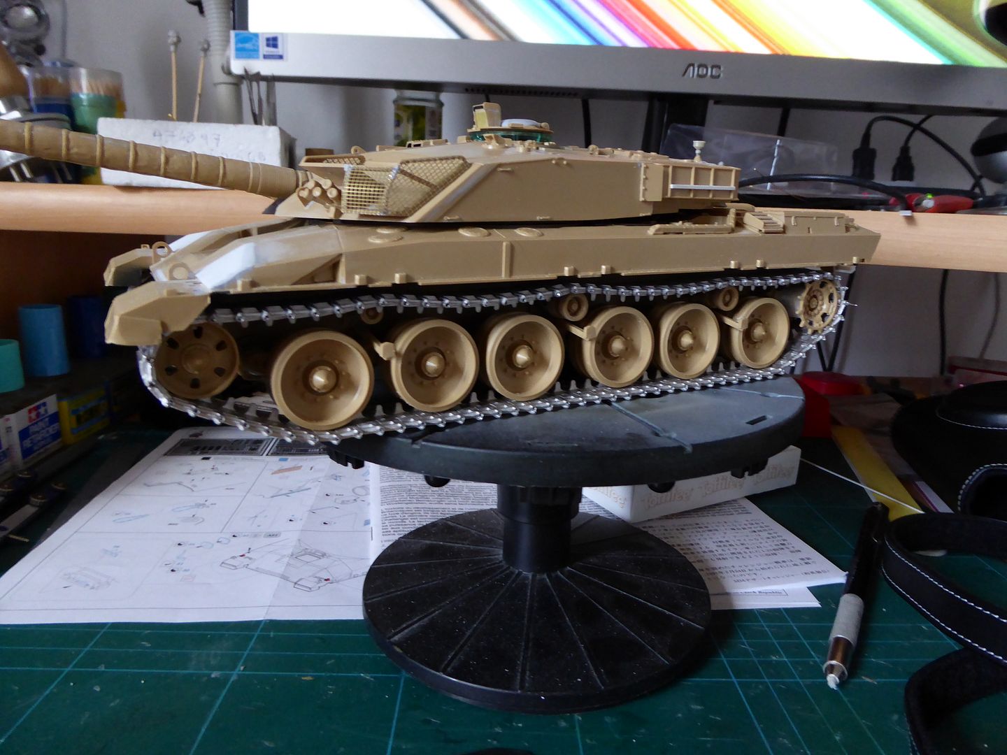

Dads203 Posted July 30, 2015 Author Share Posted July 30, 2015 Thanks Guys, A bit more done, still need a bit more tidying up but getting there. Kit supplied barrels and brackets. Cheers Dan 2 Link to comment Share on other sites More sharing options...

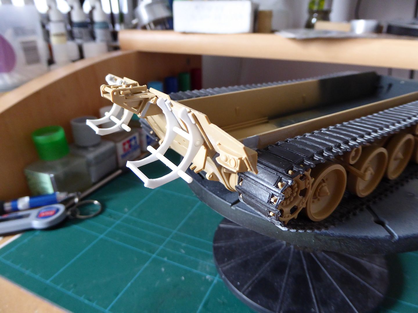

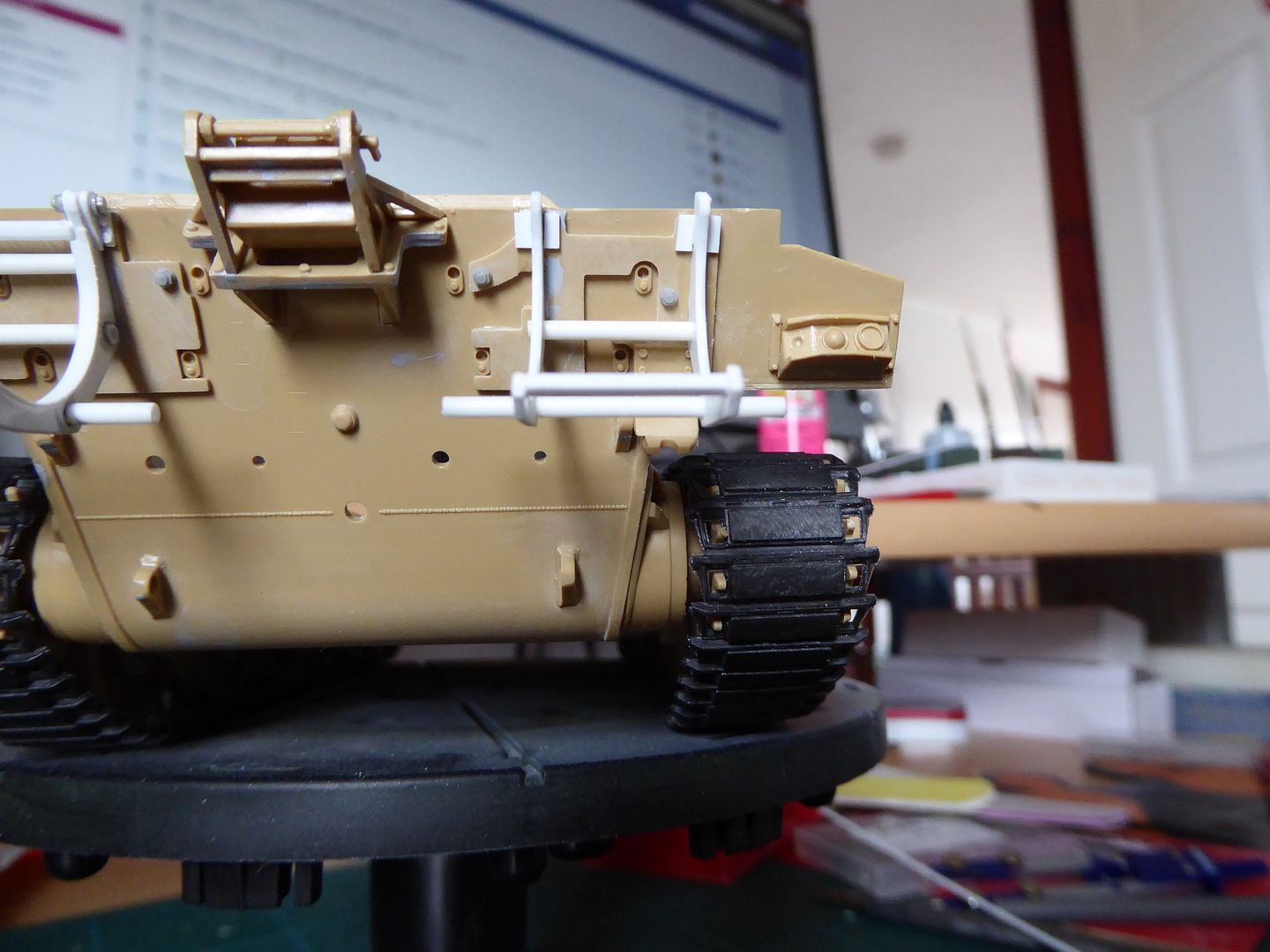

Dads203 Posted July 30, 2015 Author Share Posted July 30, 2015 Some tidying up done on the bracket. The commander sight unit door seal will need sorting out, Crew job ! next big job, tie downs for the turret. Enjoy Dan 3 Link to comment Share on other sites More sharing options...

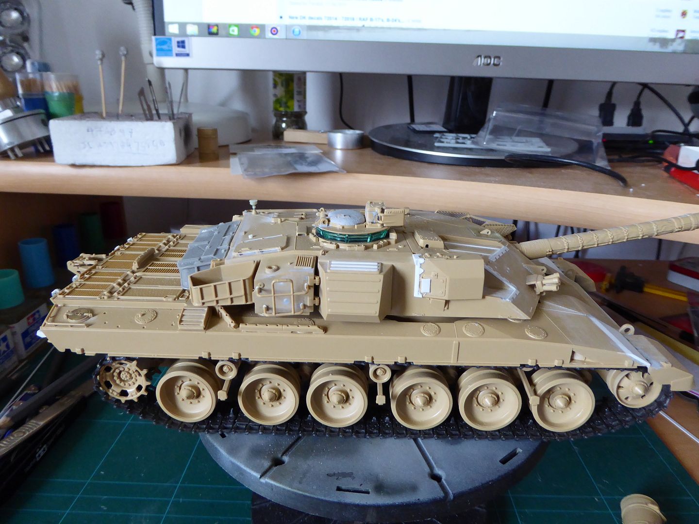

Hamden Posted July 31, 2015 Share Posted July 31, 2015 Those barrel holders really look the part. Seeing the whole model together shows the amount of hard work you have put in to correct/improve this kit! Roger 1 Link to comment Share on other sites More sharing options...

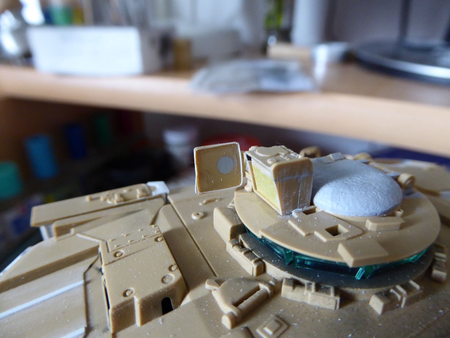

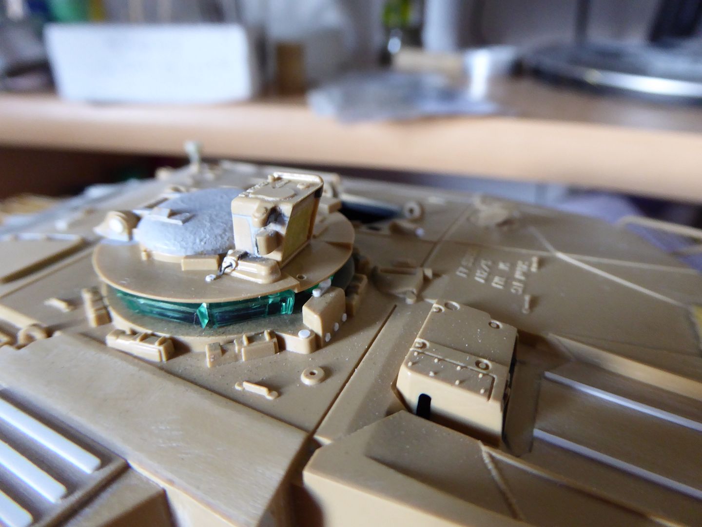

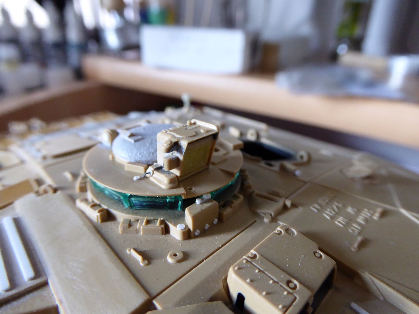

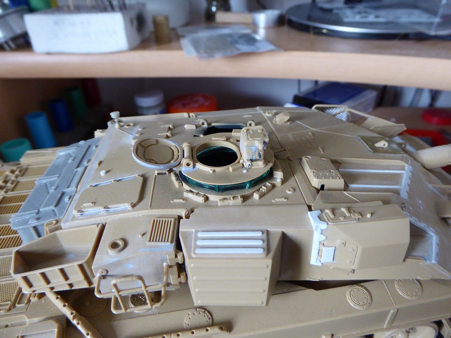

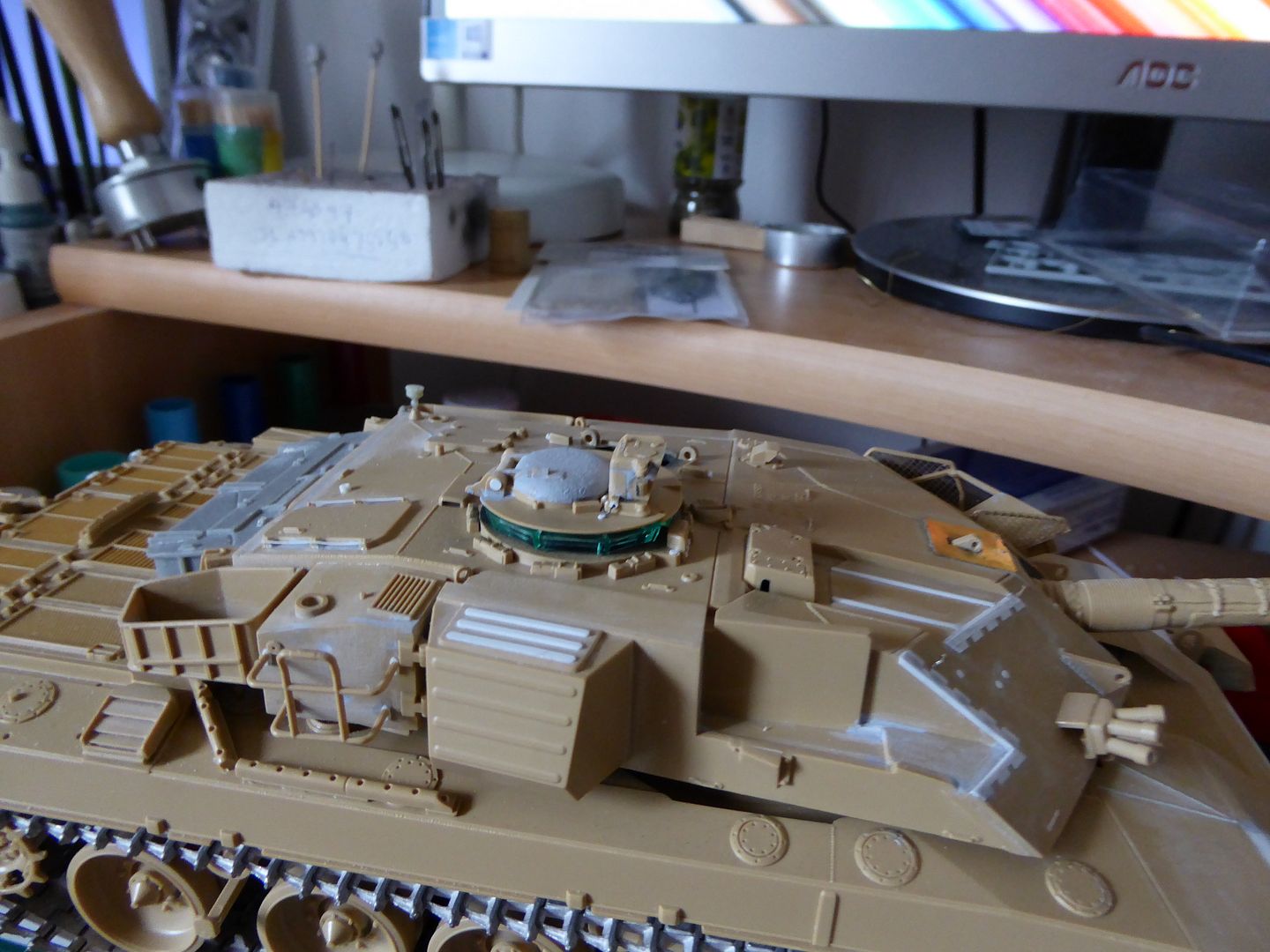

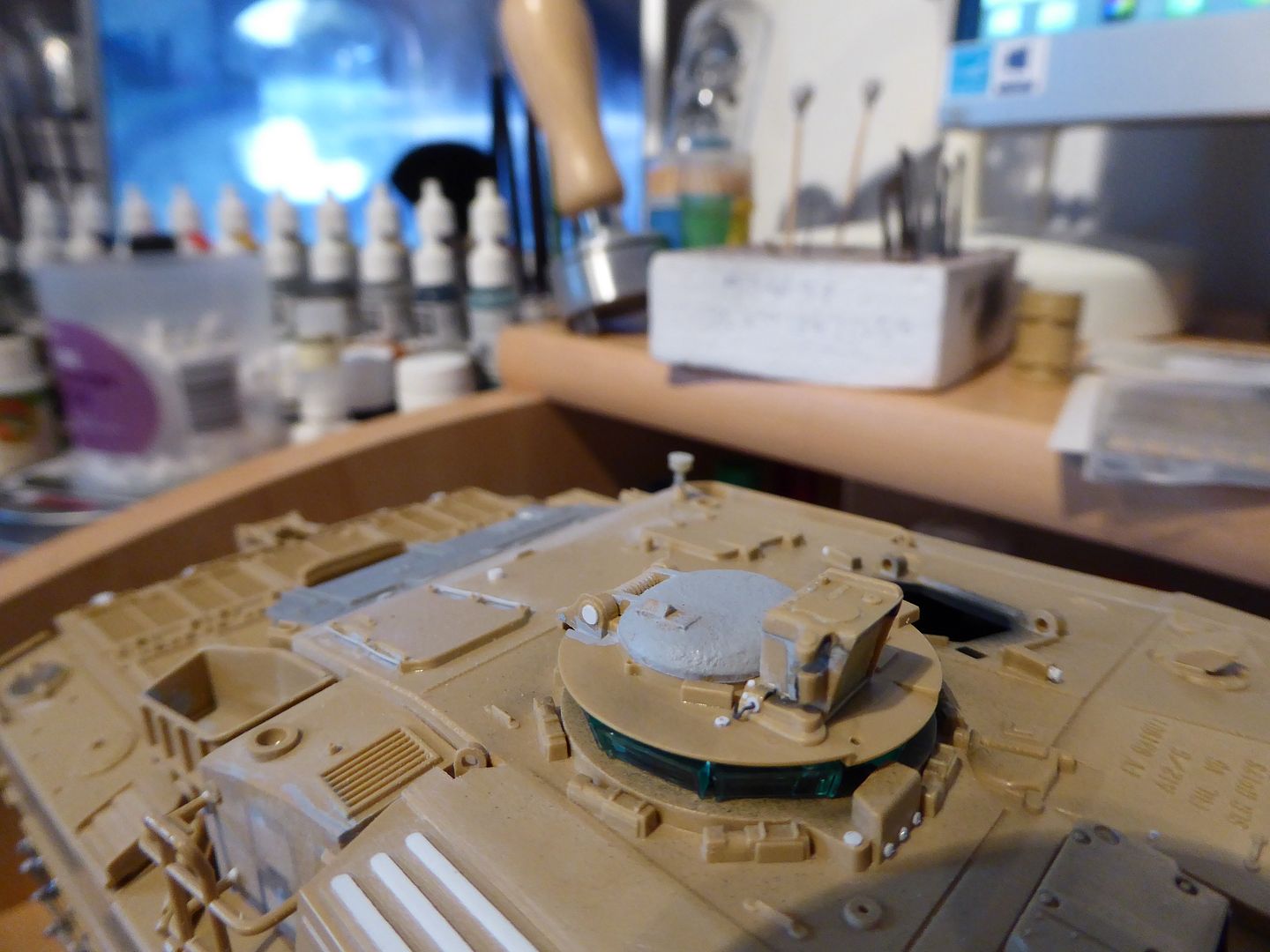

Dads203 Posted July 31, 2015 Author Share Posted July 31, 2015 Thanks Chaps, So moving onto the commanders hatch area, I've started to detail it up. Just a few bits of wire and plastic stock at this point in time. Dan 3 Link to comment Share on other sites More sharing options...
Widow 65 Posted July 31, 2015 Share Posted July 31, 2015 (edited) Dan, Great to see you "back at it " again and that the Chally is coming along nicely (as usual) but.......looking at your pictures of the fuel drum carriers I noticed that you have them being attached by adding on "nuts and bolts". This started me thinking as I didn't recall ever having to remove nuts and bolts to take off the carriers. I had a feeling that they were secured to the brackets using a different (easier to remove) mechanism. Ive just come back from working on the Prairie in Canada and took some photos of Chally 2, a couple of which showed the fuel drums and carriers. Ive looked at them tonight and confirmed that they were secured differently and as I first thought. This then go me thinking that the securing mechanism was just for CR2 so......delving into my "archive" of Chally pics from years ago I found a photo showing how they were/are attached to the brackets. see below: <a href="http://s1153.photobucket.com/user/nickflack/media/46a1eaa4-db76-4612-9e60-5d339828bbe4_zpscpo6mg8z.jpg.html"target="_blank"> The mechanism is made up of a smooth pin with a ring going through one end attached to a captive cord attached to the bracket. Following this is a large flat washer which sits against the carrier. On the other side of the carrier and bracket the pin then has another flat washer attached with everything secured in place by a split pin going through the hole of the original pin. This makes it easier to remove the bracket without having to use any tools other that a screwdriver to straighten the split pin. Apologies if I have once again P#ssed on your Bonfire but I know how much work you put into your models both in research and construction to make them as realistic as possible. Hopefully this little "nugget" of info will help with that. Sorry for the quality of the photo, its scanned from a negative. Cheers Nick. Edited July 31, 2015 by Widow 65 Link to comment Share on other sites More sharing options...
Dads203 Posted July 31, 2015 Author Share Posted July 31, 2015 Nick, Thanks for the picture fella, just what I needed, I'll be amending the build to reflect the pic, finding material Of the brackets in this detail is really difficult and the picture posted is worth its weight in gold. Dan 1 Link to comment Share on other sites More sharing options...

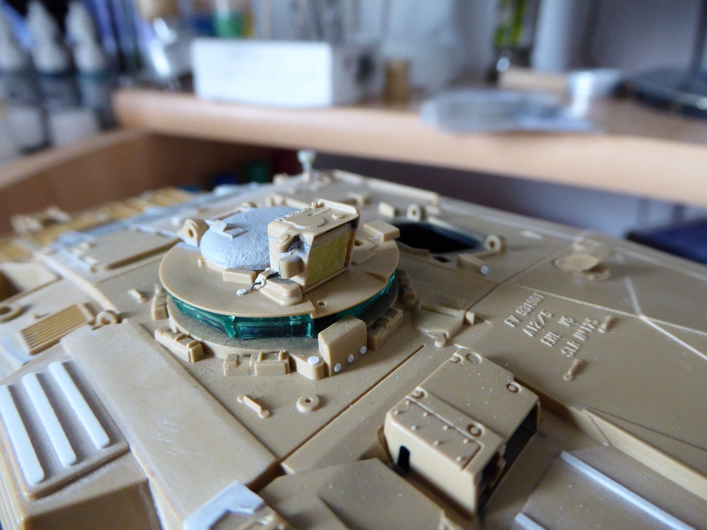

Dads203 Posted August 1, 2015 Author Share Posted August 1, 2015 A few more pictures with some missing detail added around the commanders scopes. Next up will probably scratch building the GPMG ammo box holder and the GPMG mount. Dan 3 Link to comment Share on other sites More sharing options...

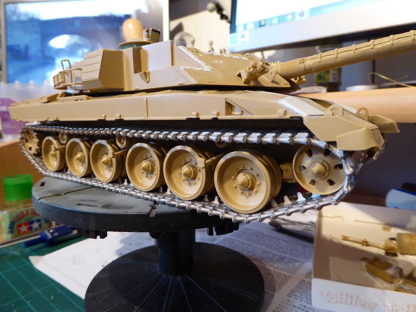

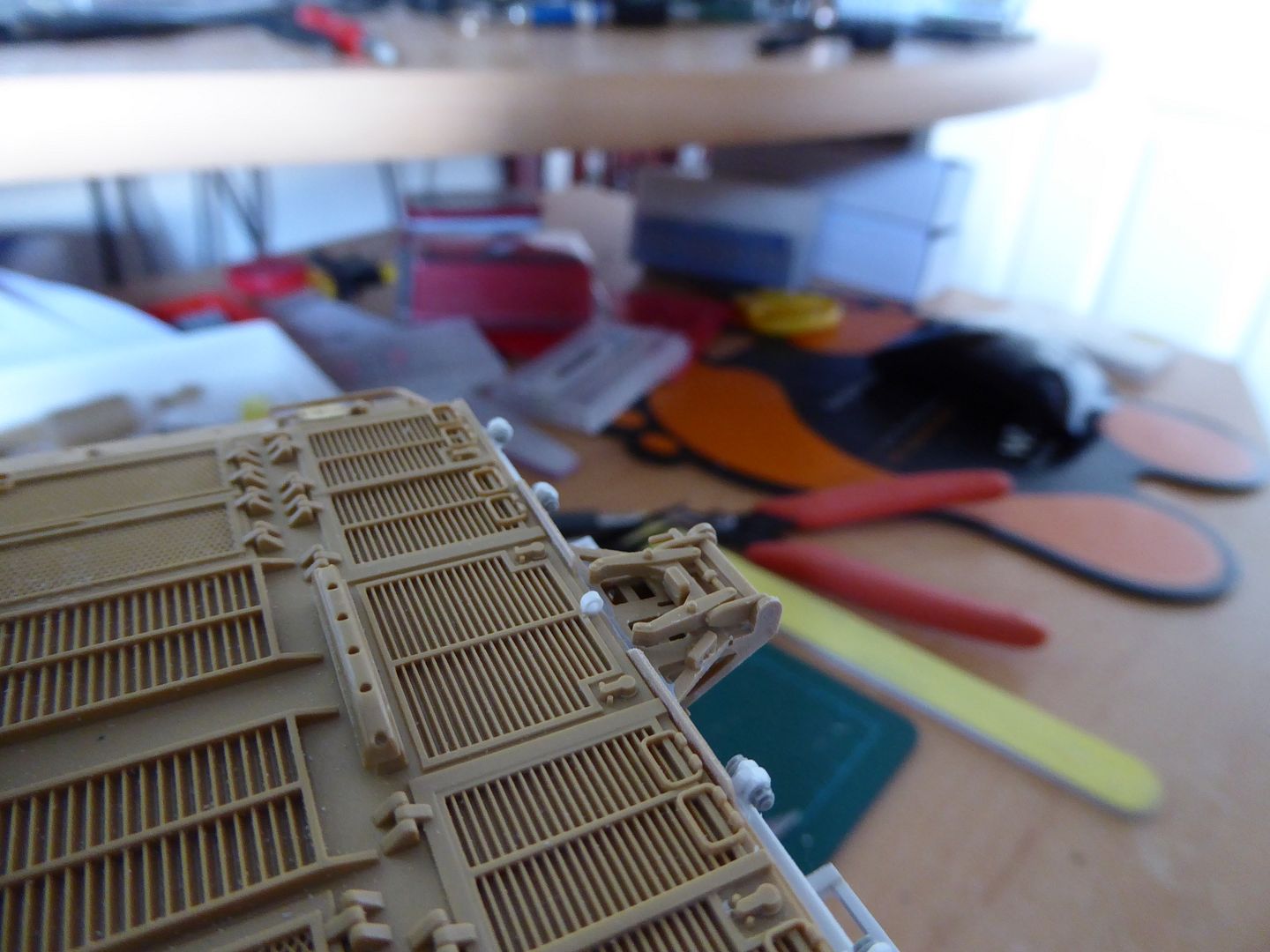

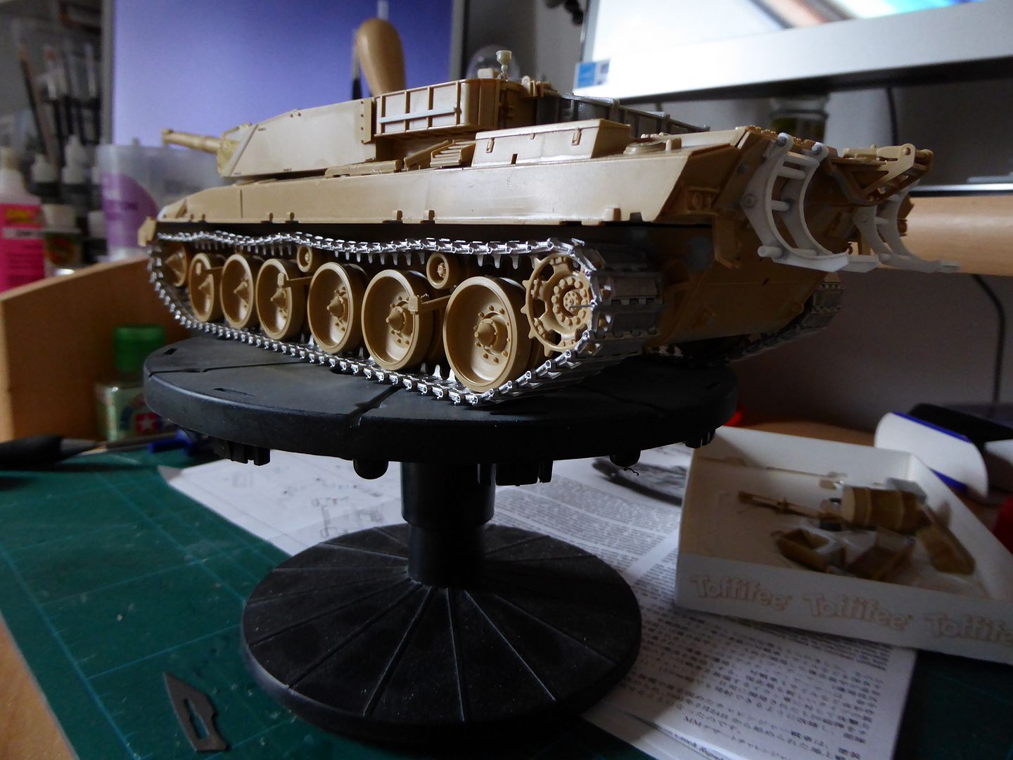

Dads203 Posted August 2, 2015 Author Share Posted August 2, 2015 Track bash time, Both sides now done, only placed on to check lengths, they will be removed for weathering. A bit more detail done to the commanders hatch. Enjoy folks Dan 1 Link to comment Share on other sites More sharing options...

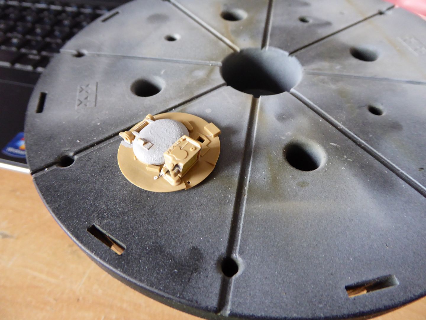

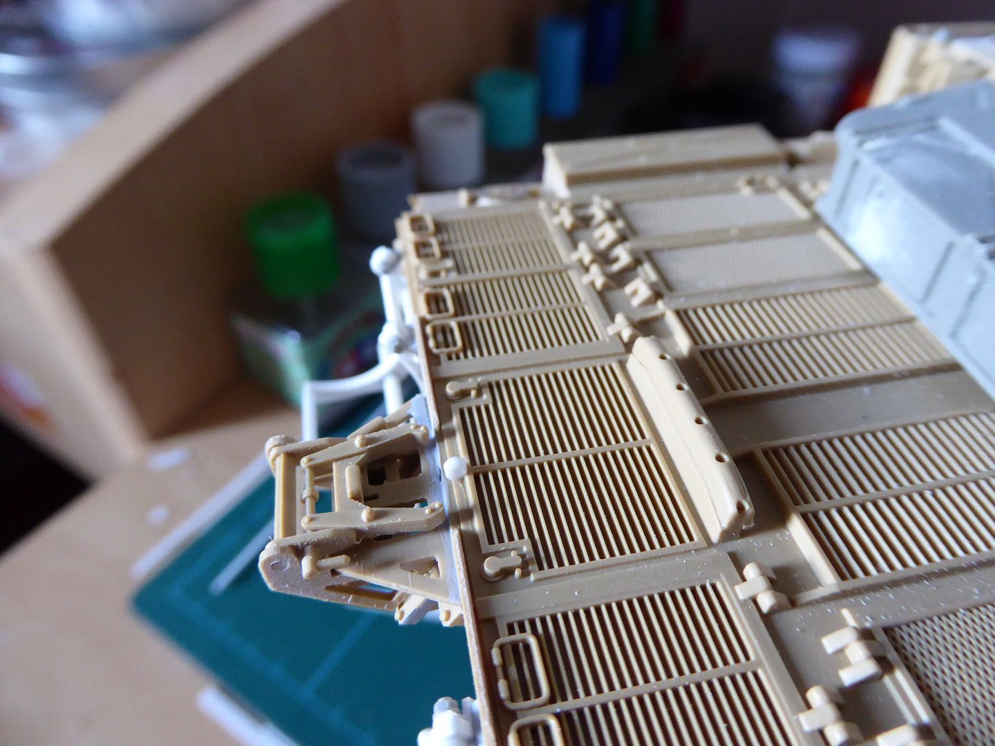

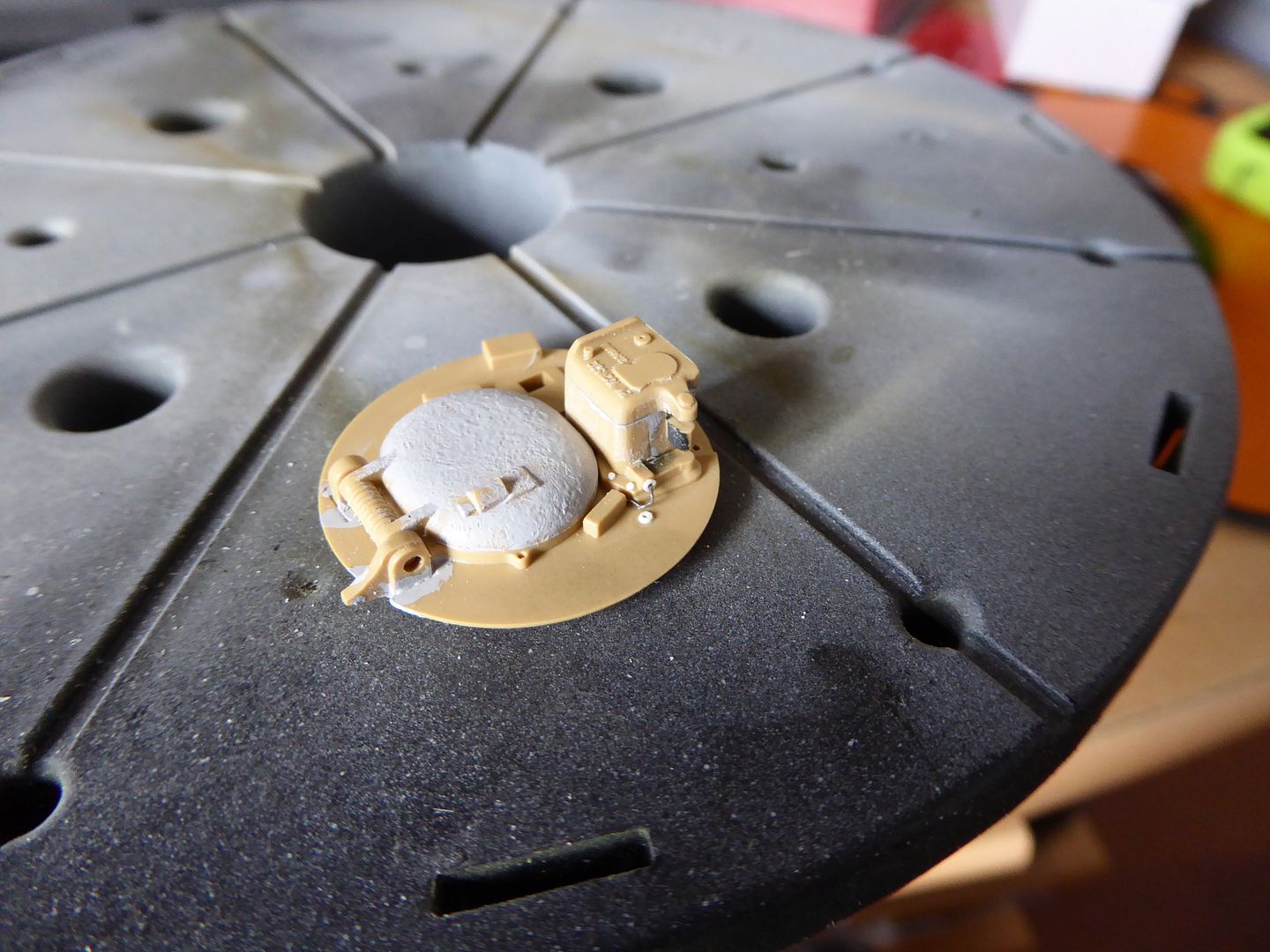

Dads203 Posted August 3, 2015 Author Share Posted August 3, 2015 An hour at the bench this afternoon, Made up the support bracket for the front of the commander cupola, not sure what its for but possibly the box that contains the wiper motors for the commanders scopes. one of the lifting lugs from the back deck. More later folks Dan 3 Link to comment Share on other sites More sharing options...
