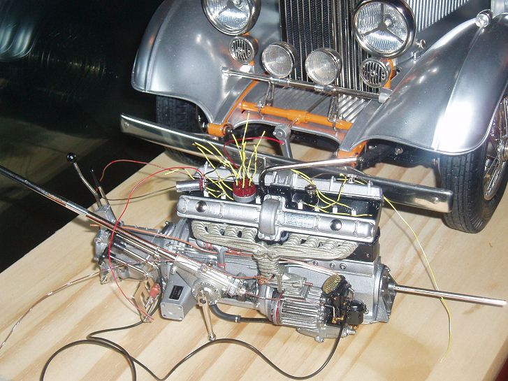

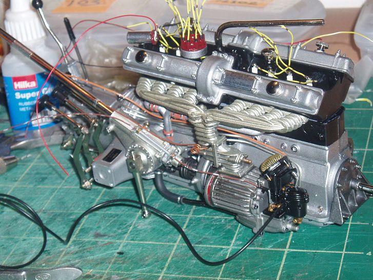

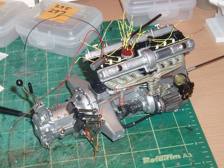

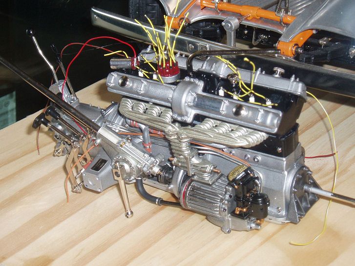

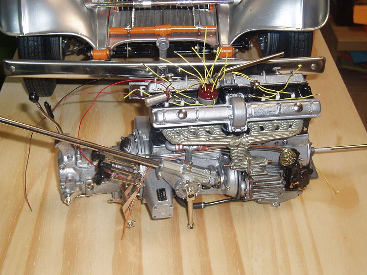

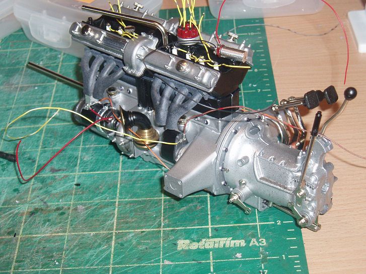

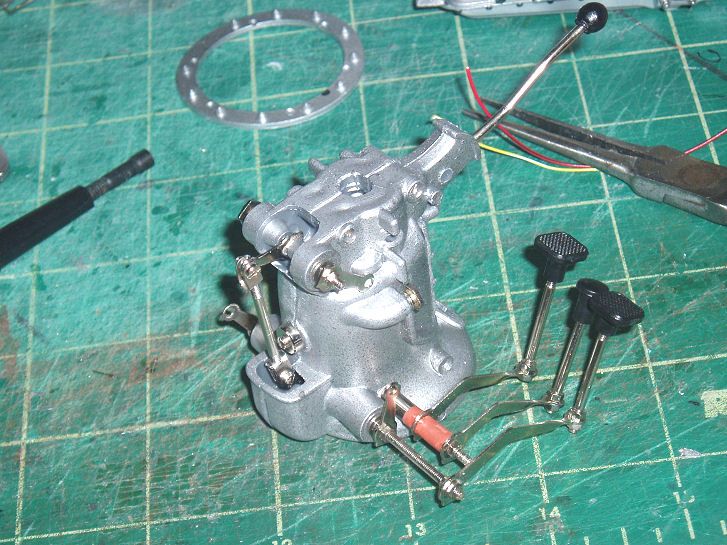

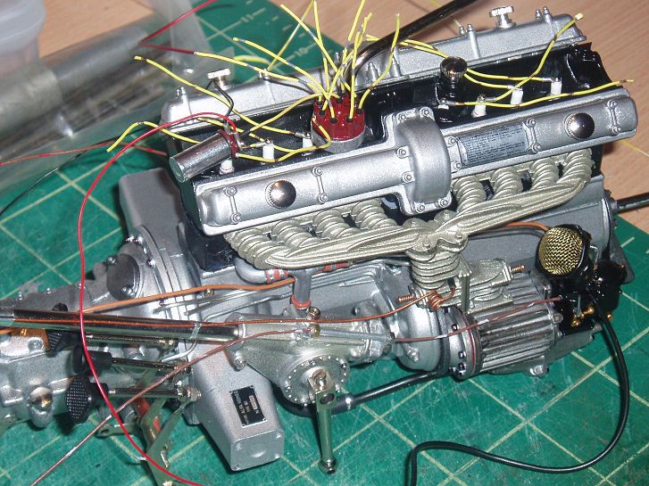

roymattblack Posted September 25, 2014 Author Share Posted September 25, 2014 (edited) The engine has been put to one side for a while although there is still a fair bit of extra detailing to do, as the gearbox needed building up. I’ve mentioned previously that if you consider buying a Pocher classic kit, get the earliest version you can find if at all possible. As these kits got older, Pocher made newer batches and changed the box art several times so it’s easy to tell the ‘age’ of your kit.Unfortunately, Pochers’ tooling was never the best, and with age the moulds wore fairly badly meaning later incarnations of the kits – particularly the Alfa’s – suffer from lots of flash and sometimes, degraded detail. Mine is a later model. The gearbox is made up of five plastic parts with lots of metal additions.The plastic parts need cleaning up. In my case, lots of cleaning up. Don’t let any of this put you off buying ANY Pocher classic though. It’s all part of the ‘project’ nature of the work. Once cleaned and test-fitted, the parts were painted, stained and bolt detail added.The DVD came back into its own again now as trying to fathom out the construction of the metal linkages etc from the dire kit instruction book is a bit like trying to understand a map of the London underground if you are from Botswana and only speak Swahili.The DVD takes you through the entire build, bolt-by-bolt, in thousands of annotated photo’s. Once the gearbox unit was built up, the pedals and other linkages were added with a good deal of fettling to get the pedals to line up as they should. No doubt further adjustment will be needed later on when the firewall and floor are fitted. The assorted bolts etc were detail painted and finally the gearbox was mated to the engine.Quite a substantial lump now. Roy. Edited September 25, 2014 by roymattblack 1 Link to comment Share on other sites More sharing options...
noeyedears Posted September 25, 2014 Share Posted September 25, 2014 the engine is already lookin impressive, how long have you been doing this one? Link to comment Share on other sites More sharing options...
roymattblack Posted September 25, 2014 Author Share Posted September 25, 2014 I've actually on been on it nearly 2 weeks but bear in mind I work on it around 4-8 hours a day Mon-Fri, and 2-3 each day Sat. and Sun. In all, I'd guess around 60-70 hours so far. I'm going to leave it alone for a little while as this Alfa is nowhere near as complex as the Rolls Phantom I built, and I don't want to find I've finished it in a matter of weeks to come. There's still a lot of detail to add to the engine though, so I'm going to sort that before I give it a break. Roy. 1 Link to comment Share on other sites More sharing options...

roymattblack Posted September 25, 2014 Author Share Posted September 25, 2014 A small update... Next on the list of ‘to do’s’ was the steering box and column.Quite a bit of adjusting, cutting and trimming was needed here as OOB, the box will fit nicely to the engine, but then foul the main frame later on. It needed to be trimmed and re-shaped on the inside face to move it around 2mm closer to the engine. Once done, the column also lines up better with the hole in the fire wall. Another alteration was to dump one of the kit parts and make a new one.On top of the steering box to one side, the kit provides a threaded rod about 25mm long, to be bolted through a flange on the front of the ‘box.In the kit, this rod serves absolutely no purpose.Inspection of the real steering box in photo’s shows it should actually be a hollow tube, with the accelerator and choke cables feeding through and along it, with an adjustment nut at each end. The rod was dispensed with and a piece of fine bore ally tube replaced it with miniature nuts at each end as the adjustment nuts.An extra bracket had to be made up for support of the tube at the upper end, as per the real thing.Once fitted, more connections were made for the choke and throttle cables. I also had to fabricate the sensor from the intake manifold and the fuel line intake to the carb. I've stood the engine in front of the Rolls to give an idea how 'small' the Alfa engine is compared to the Rolls Royce.... Mind you, it still measures 7" or 180mm from block front to rear of gearbox. All good fun. Roy. 2 Link to comment Share on other sites More sharing options...

noeyedears Posted September 25, 2014 Share Posted September 25, 2014 How much of that alpa engine is metal? Link to comment Share on other sites More sharing options...
Codger Posted September 25, 2014 Share Posted September 25, 2014 If you can point me to any reference pictures etc, I'd like to give it a look.... Roy. Glad you're interested. 'The Complete Car Modeller' Volume 1, by Gerald A. Wingrove. Pages 126 and 127, The dinner bell is ringing but right after I'll scrounge for a photo in my old archives. If you go night-night, it will be there first thing in the AM. CAUTION: You'll love it.... Link to comment Share on other sites More sharing options...
roymattblack Posted September 25, 2014 Author Share Posted September 25, 2014 (edited) Many thanks all you guys. The Alfa engine is: BIG bits - (block, head, manifolds etc,) plastic, smaller bits - metal. That probably doesn't help much, but it would take an age to try to list the relevant bits. Re: Sabre dance.... It took me about 6 weeks to get it 'reasonably' ok, then the next few years gigging to clean it up a bit. As it happens I'm gigging this Saturday, on the strength of that one number - somebody heard me play it, passed on the info, and now I have a 45 min cabaret spot at a club... Good fun. Roy. PS.... I'll be looking for the Wingrove pics. . Edited September 25, 2014 by roymattblack Link to comment Share on other sites More sharing options...

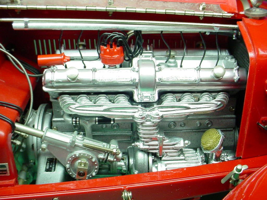

Codger Posted September 26, 2014 Share Posted September 26, 2014 I apologize because these are probably useless for you but they're all I have. Thirty-four year old shots taken on print film and scanned-horrible. But I'm giving all I have. Didn't do WIP's in those days........ A possible resource (I haven't looked yet) is Marvin's 'Finished Alfa Romeo Gallery' at Modelmotorcars.com. It's a wealth of visual info on how other builders finished this car. / Here is the wonky engine installation with associated horrors. It's a wonder I even got the thing together looking back... Link to comment Share on other sites More sharing options...
roymattblack Posted September 26, 2014 Author Share Posted September 26, 2014 Many, many thanks for the pics. A lovely model. I'll have a peep on the Pocher websites. You've piqued my interest now - so I might just have to alter my wings/running boards/bodywork. So... It's only 'time'. Instead of finishing the build in 'X' weeks/months, it will take 'X' + a bit more...... To all you 'tempted' people... THIS is what makes Pocher kits so ACE!!! As I've already said - they are a PROJECT. GET one! Roy. 1 Link to comment Share on other sites More sharing options...
