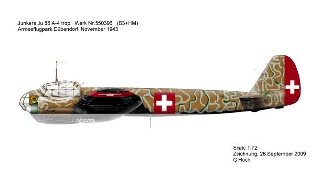

Clinton78 Posted May 11, 2013 Author Share Posted May 11, 2013 Here are the Swiss Ju88 Photos: Some saved text I have accompanying the photos, apologies as I failed to record the original source (possibly TOCH or LEMB): WNr.550396 Ju88A-4 (ATG Leipzig) TK+SF / B3+MH. this Ju88A-4 that flew with 1./KG54? and landed in Dübendorf Switzerland on 21 Oct, 1943 after the crew had lost their bearings. The aircraft was painted water-blue (unknown hue) on its upper surfaces throughout, upon which a wave-type pattern (sand yellow Nr.79) had been sprayed. The lower surfaces bore black night camouflage. The standard-size original Balkenkreutze were painted over probably with the same special type of camouflage and replaced by small crosses on fuselage and wings, outlined in white. The small Geschwader code “B3” was ahead of the Balkenkreutz and call and squadron letter were in standard size, being repeated on the flame suppressor tubes over the exhausts on both engines. The original black swastika with the black border was kept on the rudder but integrated into the wave pattern. The Geschwader emblem (a small coat of arms) appeared on both sides of the note.” Merrick adds quotes from a Luftwaffe member and RAF intelligence reports from Foggia, all pointing to an overall blue as the base for the sand "Arabesque" or wave-mirror. Also Common use of dark green undersurfaces. The main discussion is in book 1, as part of the discussion of the two sets of desert colours 79/80 as used by the Luftwaffe (not Italian colours!). Merrick thinks the blue is the earlier, darker, 79 which was possibly replaced by the later colour, as the RAF reported light blue. Link to comment Share on other sites More sharing options...

sloegin57 Posted May 12, 2013 Share Posted May 12, 2013 All of the above is, IMHO, perfectly plausible and logical for reasons that I will give in a later thread. In the mean time and to indulge in a bit of relaxing modelling as I have been scanning negs for a month now and could do with a break, I have just dragged out of the deepest stash, the Italeri 72nd Ju-88 which, if I read this topic correctly, purports to illustrate the "Swiss" Ju-88 described above. OK - 1.) 72tooth is not my scale. 2.) Luftwaffle WWII is not really my area. So which colour on the kit painting chart do I change to "blue" please. Apologies for going "off-topic" DR Link to comment Share on other sites More sharing options...
GrahamB Posted May 12, 2013 Share Posted May 12, 2013 Hi, first off - and I don't want to get into the usual Luftwaffe-camouflage arguments that can readily deteriorate - please remember that the supposed 'blue' camouflage of the Swiss Ju88 is Merrick's interpretation, not the actual colours in the Swiss report (merely 'desert and water'). One has to be careful quoting from sources like that (the very pale meandering lines cannot possibly be RLM79 anyway, tonally). Secondly, I have been a follower/fan of Luftwaffe camouflage for over forty years and I think that Michael Ullmann's findings on RLM 83 are the most significant of this period. If you read my posts carefully you will see that I am not trying to refute this at all - far from it - it's great news. My first post was only to say that a 72/83 or 70/83 scheme would be difficult to distinguish from the 70/71 or 72/73 types in b/w photos, especially if it was overlain with Wellenmuster in RLM76. I don't know yet if Michael Ullmann has a colour sample for this blue but I would hazard that it would not be highly saturated and would be tonally lighter than either RLM72 or RLM70 in order preserve the overall pattern. Thirdly, I am not Graham Boak. Cheers, GrahamB Must dig out my long-stored 1/48 Ju88 and paint it up. Link to comment Share on other sites More sharing options...

popeye Posted May 14, 2013 Share Posted May 14, 2013 (edited) ..... So which colour on the kit painting chart do I change to "blue" please. ... DR OMG - what kind of pandora has been opened by dear Michael No Dennis - you don't have to change anything to "blue" .... Why oh why nobody thinks of asking where the pics of the interned Ju 88 come from ? Georg Hoch, author of "Me 109 in Swiss Service" has also published a book on camouflage and markings of the Swiss AF 1915 - 1950 http://www.ipms.ch/plugins/forum/forum_viewtopic.php?66 Also covered are interned a/c The profile below is included in the book - and has been drawn by G. Hoch using official Swiss documents describing the colours of the interned Ju 88. Cheers, Rolf (Profile posted with kind permisssion of G. Hoch) Edited May 14, 2013 by popeye 1 Link to comment Share on other sites More sharing options...
