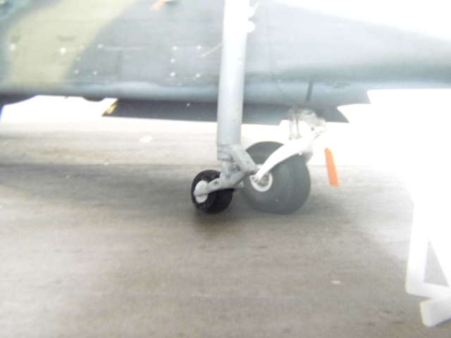

Working out the retraction gear for the front wheel leg now, I have an old Air International with a Sherpa cutaway drawing that can be used with some interpretation
Coming along gently again
bill
Link to comment
Had some fun recently
OK NOT!
When I looked at the two wings in place after number two dried I realised that although they were perfecly aligned from the front, the port wing was actually a good 3/32" out of line towards the back of the fuselage
Out with the razor saw, off with the despair and redrill, repack with 15 thou and more carefully redo from start (I notice that I don't get that instruction with Windows kit, must be some upside to memory hungry OSs huh) So with the wing set on properly I did some of the other smaller stuff.
I finished carving the front wheel yoke and added the top pivot brace
then began assembling the rest of the front leg
this needs the link trimming to size, I have kept the thicknesses as small as is feasible but with small items a little extra beefing up may be needed. If this does need stiffening I will paint a thin layer of cyano (YUK) over all the linked pieces so the skin of cyano adds stiffness without much extra bulk.
The famous coffee stirrer wheel is in place for testing, looks fine to me, all to be painted tomorrow (I'm off out to the fleshpots of London tonight...OK Its Classics at the Ace Café tonight, meeting some mates. Planning this year's trip to Le Mans)

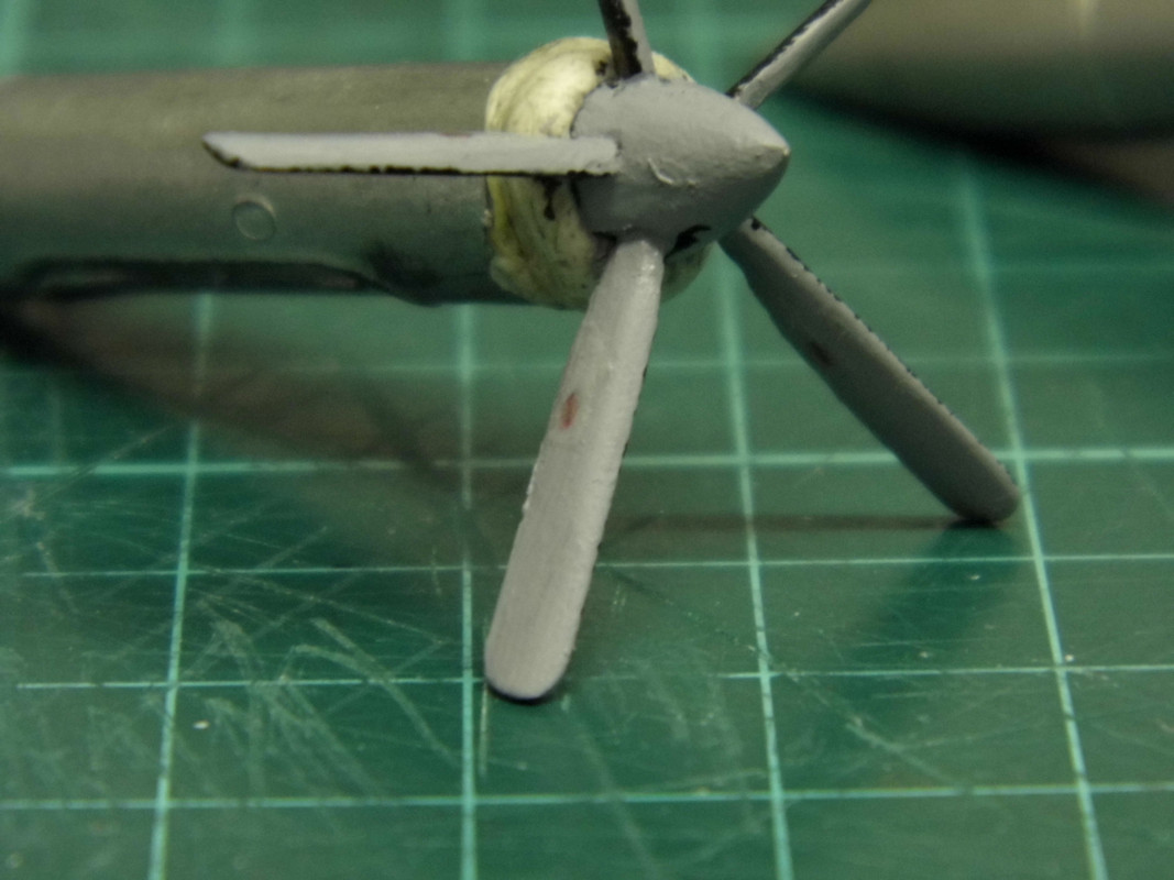

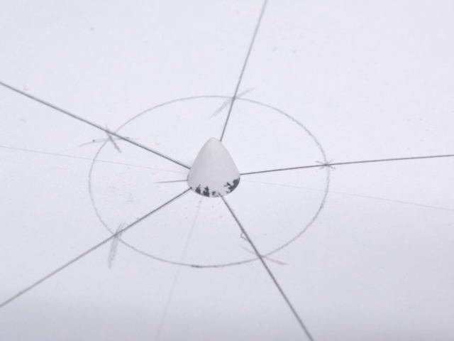

I've been working at the props, as Nobby implied correctly no easy task
Each blade needs to be 72º round the spinner from its neighbours, so marking out and attempting to drill has been one of those-things-to-do. Here is the spinner being marked off for the blades
It's not dead centre here, but was when drilled
Making blades isnt easy either, I'm thinking of making one good prop then moulding a few off the blank if it comes out nicely
The blade shape isnt easy either, took a while to get the shape sorted, which means that I will probably not use these ones
I have a plan C for these :)

More fun and games with the props now, fingers crossed for me please chaps

Not done much with the props yet, it's quite a daunting prospect, maybe I've let it worry me too much. We'll see at the weekend purrups.

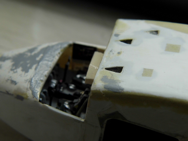

Just been doing the interiors for the cockpit, one side panel is the fuel controls, the other seems to be a radio/signals suite
The I.P has been marked out and the painted holes filled with Krystal Kleer. I have made no attempt at figures or needles, I justwouldnt expect to see them inside through the small windows but I have left the whites of the Artificial Horizon bubbles empty. They look like the pictures I have of the real C23A items
In this picture the Krystal Kleer hasn't dried "Kleer" yet but you can see the pair of white artificial horizon dials recessed on the panel
The small boxes on each side panel are the crew's stowage for maps and documents, quite visible on pictures of the cabin area
U girder sections from Evergreen cut to suit
You can just make out the side panel and docs case on the poor picture I really do need to develop photography skills
I'm sorry about these, how about I try again before I close up the cabin? Tonight with luck

not much more yet
fitted canopy/roof/windows
making good with Perfect Plastic Putty, so far it seems to be just about perfect, dries quickly and sands down nicely
Just a pic of the filled canopy
More tomorrow or later
bill
Edited by perdu
Link to comment
