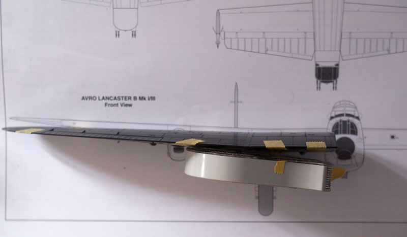

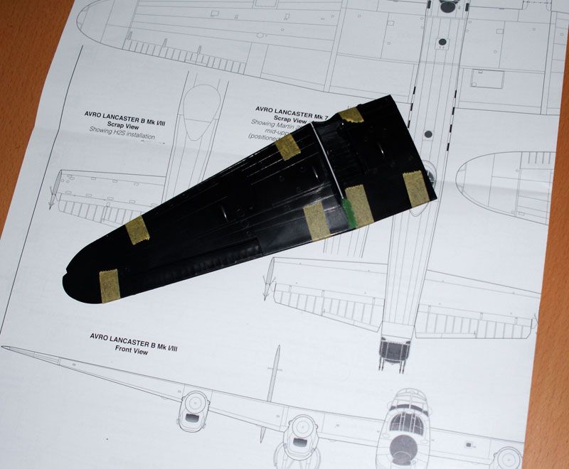

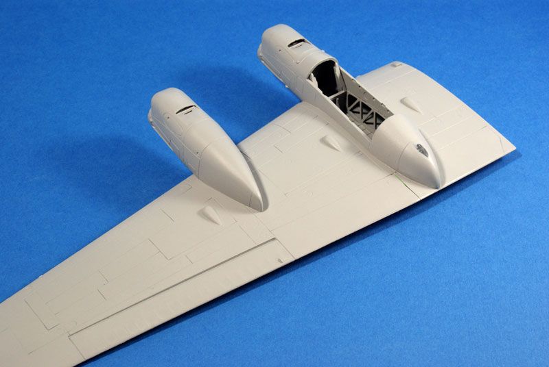

woody37 Posted December 27, 2012 Share Posted December 27, 2012 Building this as part of the Bomber Command sig in prep for the 70th anniversary events that are happening in May.AJ-Z was flown by SL Henry Maudslay and was part of the first wave sent to attack the Eder Dam. He attacked between 01.30 and 2am, having two failed attempts before dropping his upkeep. The bomb bounced over the damn exploding on the otherside which is believed to have damaged the aircraft. Sadly, on the return leg, their Lanc was shot down over Emmerich at 02.35 with the loss of all on board. This is my tribute to that crew.The plan..Largely out of the box, there will be a few aftermarket replacements, namely the wheels and gun barrels which are not great in the Revell kit. I'm also using the mask set which I've come to like very much !!I'm also going to see if I can get the Falcon front turret (designed for the Airfix kit) to fit to improve the look of the nose area too unless anyone else has already tried and failed ????Well documented is the issue with the dihedral on the wings being too low, so following a tip I've seen somewhere, the wings were assembled and the main gear bay spars inserted for strength. A slit in the lower wing was then made with the razor saw and a plastic shim added which 'forces' the wing into the correct dihedral...The unmodified wing (apologies for the poor pics, I've not got my stuff set up properly)The corrections to the starboard wing using 0.5mm plastic shim...Cheers, Neil 5 Link to comment Share on other sites More sharing options...

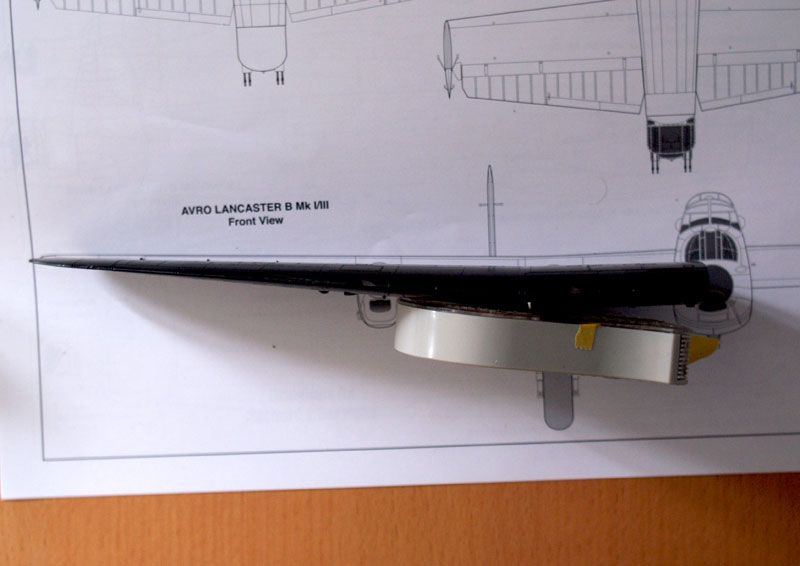

woody37 Posted December 27, 2012 Author Share Posted December 27, 2012 Cheers guys. General, which is this build of Bills you refer too ? Always on the look out for tips n tricks n inspiration I was tempted to get some etch flaps but never got round to it. Jonny, this is the first time I've done this although the fourth Revell kit i've done (Mk.I never knew about it until after the build, then a Manchester conversion, then a B.II CMR conversion). It really is quite easy as long as you have the drawing to compare against, I had to adjust the packing a little on the second wing to get the angle right. Once right, I just then covered the join in liquid poly then filler when dry. Paul, I've never done a Hasegawa kit, so would love to see a build thread of yours Here's a pic of the wheel bay in the BBMF one, plenty of opportunity to add some detail... Link to comment Share on other sites More sharing options...

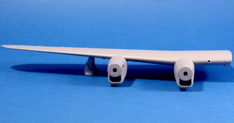

Andy K Posted December 27, 2012 Share Posted December 27, 2012 Now you have corrected the dihedral, how are you going to correct the angle of the outer engine nacelle? Link to comment Share on other sites More sharing options...

woody37 Posted December 27, 2012 Author Share Posted December 27, 2012 Now you have corrected the dihedral, how are you going to correct the angle of the outer engine nacelle? I'm not, the first wing is now done and primed, it doesn't look out compared to the inner. Cheers Link to comment Share on other sites More sharing options...
general melchett Posted December 27, 2012 Share Posted December 27, 2012 Neil, there's a good article on correcting the kit by ianlanc on the WW II Aircraft.net site a while back. I'm sure he won't mind a link to it, http://www.ww2aircra...uild-23405.html There are lots of little errors, as there seems on all of them one of the worst aside from the dihedral issue seems to be the engine facings which look too wide, but can be altered and the incorrectly positioned escape hatch atop the fuselage, I'll be cross kitting with an Airfix donor kit to sort some things out, Bill was the big hairy Frank Zappa from Philadelphia lookalike on the BC table, he did well in the comp at Telford withhis DB Lanc. Not aware of the problem with the outer nacelles, mine are fine too., unless he means the angle with the dihedral added?, no problem as the nacelles are separate pieces and easily aligned. I've got the extra flap stuff, ( included in a load of Lanc bits that the late John Godfrey gave me, bless him), but won't be adding it to this one., there's enough work to do as it is !! Link to comment Share on other sites More sharing options...
Andy K Posted December 27, 2012 Share Posted December 27, 2012 ....unless he means the angle with the dihedral added? Yes I did! I was curious as I have the Revell Lanc to do sometime. Link to comment Share on other sites More sharing options...

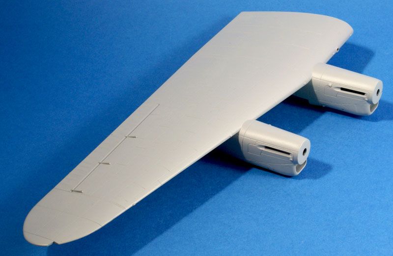

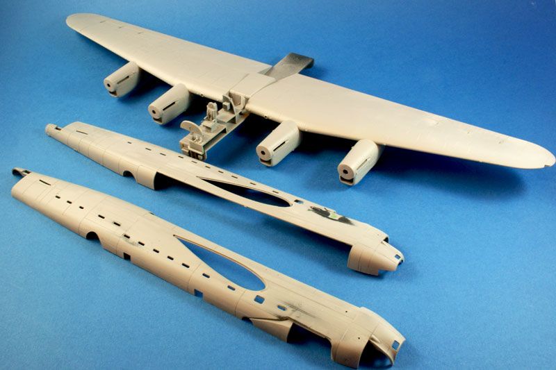

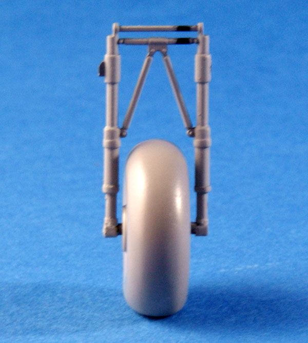

woody37 Posted December 28, 2012 Author Share Posted December 28, 2012 Cheers Andy, I had seen that a while ago but forgot about it. Hmmm. I never knew about the front escape hatch. Ignorance was bliss !!!! The resin wheels I've got have the same problem as Ians, so I'll try to replicate what he has done for axles as I've got some thin brass rod, I knew it would come in useful ! Got the wings and engines done today although I think I'll get some resin carb intakes so they're not on yet. I'll get some piccies up tomorrow. With the wings on the centre spar, it lines up well with the drawing from tip to tip so I'm happy with the progress. Link to comment Share on other sites More sharing options...

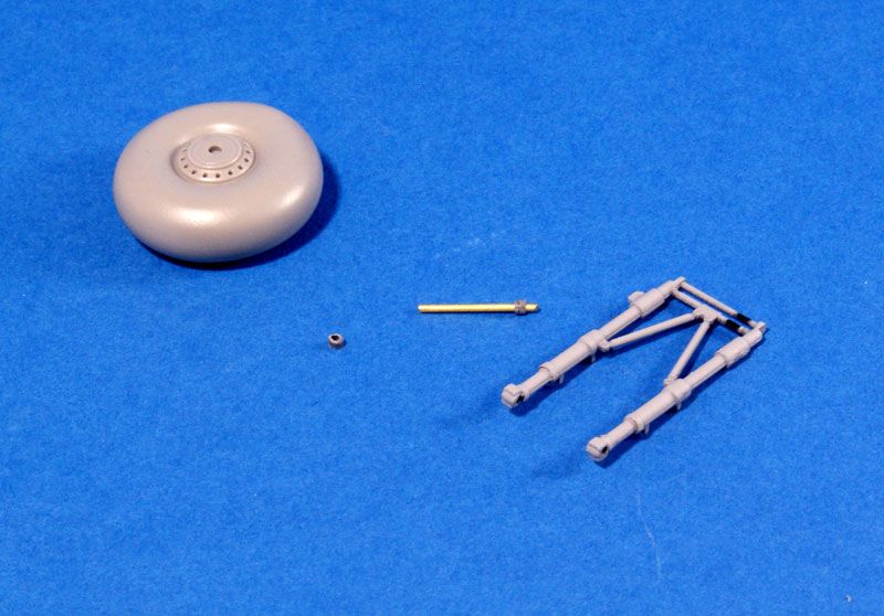

woody37 Posted December 28, 2012 Author Share Posted December 28, 2012 I agree Tom. I've decided to leave the radiators unmodified, correcting them falls into the 'too hard' category, I'm surprised there's no aftermarket replacements for these unless the ones for the Hasegawa will fit ????? I'm still deliberating over the front hatch, whether to move it or leave it. So progress so far. Wings are done and also been filling sink marks around the cockpit on the fuselage sides. Also followed IanLancs tip on creating a shaft (o.8mm diameter ) to support the resin wheels. 1mm spacers were made by drilling some plastic rod. I'm not going to rescribe the wings, happy with them as they are, you have to draw a line somewhere for sanity's sake !!!! Link to comment Share on other sites More sharing options...
woody37 Posted December 29, 2012 Author Share Posted December 29, 2012 'popped' over to Duxford today with the kids (as you do) for some inspiration and got looking at the Lanc. The radiator intakes look like they could be reworked with little fillets in each top corner to give the rounded/blended look. Has anyone tried this ? Cheers Link to comment Share on other sites More sharing options...
