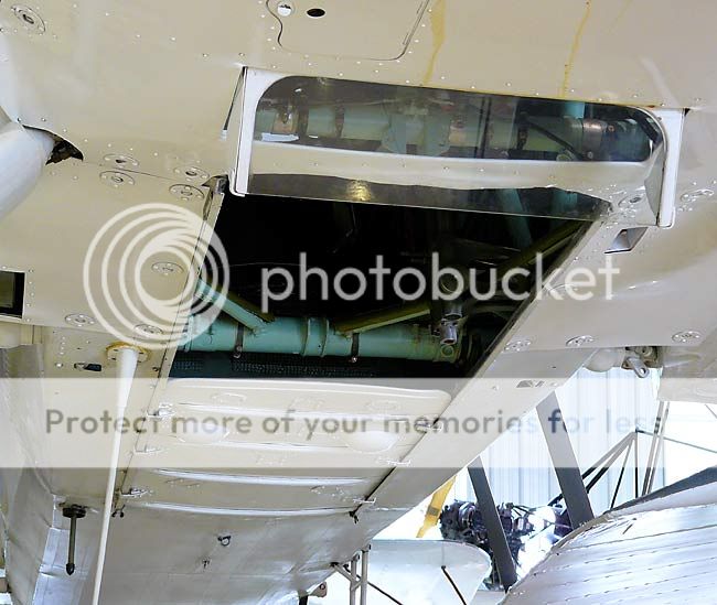

I've rounded up a few pictures here and they may give a clue as to what's going on.
Posted Image
This first one is probably the best because it shows that darker shade under the fuselage which I think must be the silver as on the wing undersurfaces. I think that the remainder of the underneath is Cerulux. I know it's the RN Historic Flight aircraft and may not be Cerulux , but it does show that fabric area.

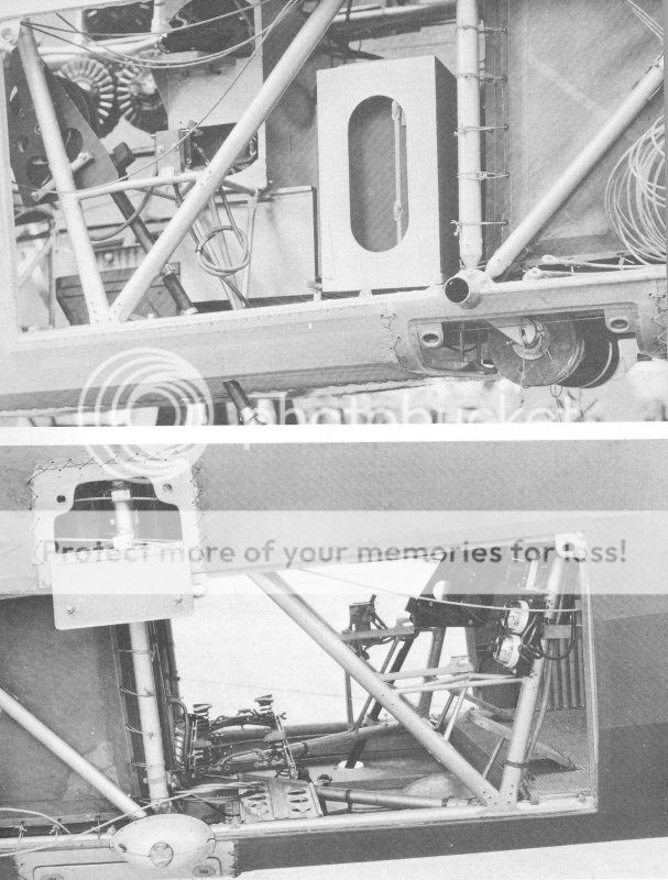

Posted Image
This picture is not really very helpful, but it does show the underside.

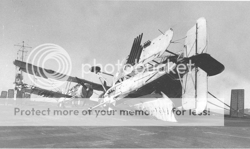

Posted Image
I've included this shot because it looks as though the lacing is visible around the rear half of the hatch. This is where the metal front section changes to fabric right across the centre-line of the hatch.

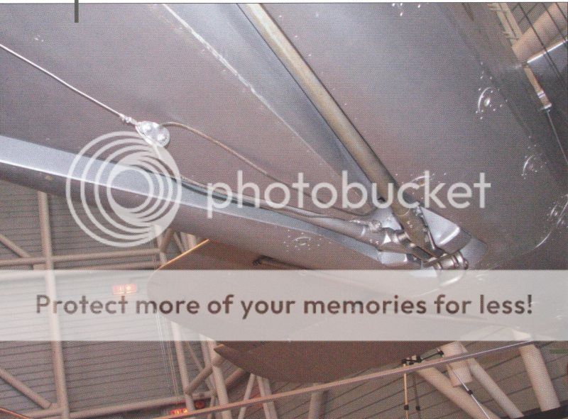

Posted Image
Two pictures showing the metal rear under section which starts just forward of the arrester gear housing and finishes at the sternpost.

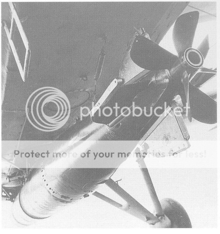

Posted Image
Also the metal side-panel either side under the tailplane.
Posted Image
These two shots are interesting because they show a removable panel (metal) across the whole underside for access to the torpedo gear or arrester gear? Not sure. You can also see where the fabric is laced to the framework. I believe this is a very early aircraft because I cant see evidence of this panel on later machines.

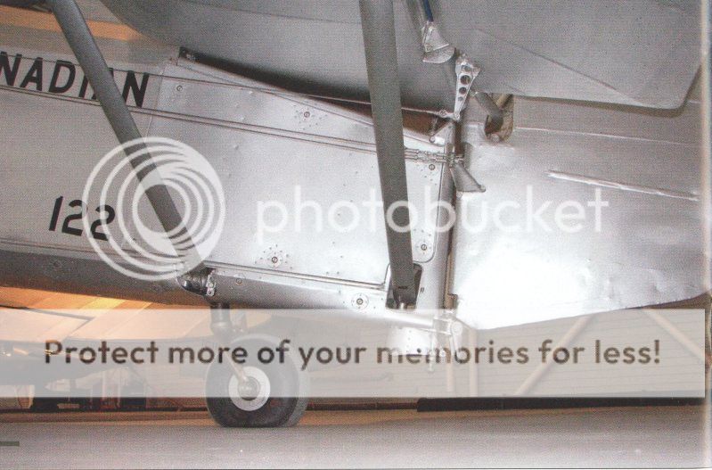

As you may gather, most of this is guesswork. I haven't got an accurate scale drawing to refer to. But I am sure there is a ribbed/fabric covered section between the circular hatch and the arrester gear metal panel. It would have helped if Airfix had moulded the under surface part (23) with more accurate detail showing the panel line infront of the arrester gear and perhaps a hint of ribbing (although it's hard to discern this on the real aircraft) up to the metal forward section which starts half-way across the circular hatch. I notice there is a faint raised line there, but it doesn't reach the hatch.
In conclusion I would say that Airfix's colour guide is correct.
I'm sure I've read that the arrestor-gear fairing could be swapped out for a plain flat fairing to prevent water getting sprayed up off the floats when fitted.
