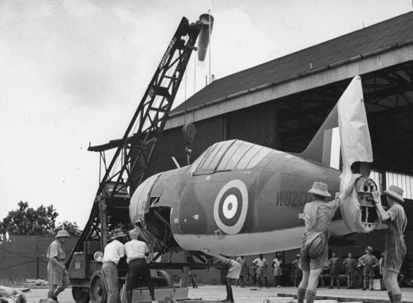

The aircraft wre painted in US "Equivalent colours" of Dark Earth/ Dark Green/Sky (not any colour grey!!!) at the Brewster
plant along with roundels
Here is a photo of an unassembled Buffalo just taken out of it's crate
Posted Image
Without sparking any debate about the colours, remember that the aircraft were ordered in 1940 around the
time of the Battle Of Britain. Think about the colours used at that time on RAF fighters.
Sky type S or any equivalent RAF sky's (eg blueish green etc) at the time (1940) just would not go with Sky Grey :wacko:
one could imagine a Flt Sgt's comments if he had to repair an aircraft with a grey lower with RAF Sky??
The aircraft were painted in Black (portside only) after their arrival with the starboard remaining in Sky
there was no Black/White to my knowledge on any of the RAF 339E's
The black portside was discontinued after a period, so you will get some 339E's with
and some with out. the Black/Sky was an identification scheme to aid the AA gunners
with aircraft recognition. In his book "Last Stand Singapore", Graham Clayton quotes
his father who was an erk with 488 Squadron, that "it really didn't matter what the aircraft
were painted, as the AA gunners shot at anything flying...." :wall:
much to the disgust of the RAF/RAAF/RNZAF pilots
Hope that helps
Alan
