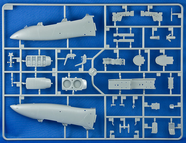

The A sprue contains the fuselage halves, and here we have a problem that will require some work if you’re so minded. The aft fuselage had an extension fitted on the B model, which begins aft of the exhaust troughs, and places the tail further back, with a longer spine than the single seat variant. I’ve not yet established the correct length of this plug, but it should be there and isn’t. A great many of us will build the kit and enjoy it immensely without caring two hoots about this, but some of us are likely to get out the razor saw and correct this issue. Which route you choose is entirely up to you!

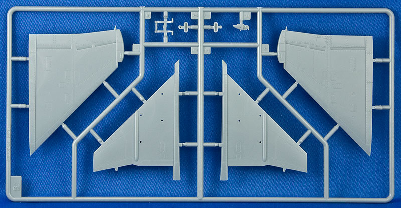

The new D sprue with the nose and two seat cockpit is necessarily larger to accommodate the enlarged forward fuselage and cockpit parts. Aft of the cockpit though, the sprues are the same as the Forger A, so I’ve reproduced those sprues here to save you flicking back and forth between two reviews.
Posted Image
Detail on the kit is very good, and again the wings can be depicted folded by cutting along the panel lines and inserting the included ribs, a feature which isn’t mentioned in the instructions again.

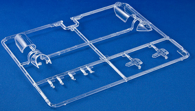

The new canopy is on a significantly larger sprue, and is supplied in four parts to enable the modeller to pose either or both of the canopies open, although no mechanism is included to enable this. The parts are crystal clear with a very fine seam down the middle of the main parts due to moulding of the slightly blown cross-section. A little distortion seems to have crept into the mould of the aft opening section, but this might well disappear following sanding and re-polishing of the seam.

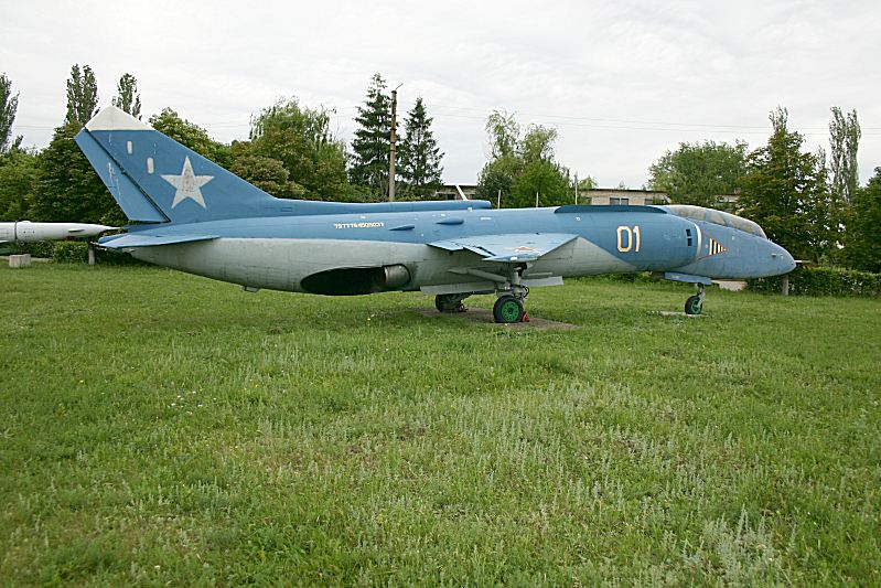

Here are a few pics I took of a Yak-38U at Lugansk - plus a single seater at Kiev for comparison.....
Single-seater.....
Posted Image
Two-seater........
Posted Image
Posted Image
The rear extension appears to be just aft of the jet pipe - end of the 'scallop' is in line with the dorsal fillet on the U.
Dunno what size the extension is though......
Ken
