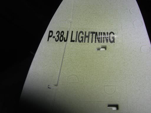

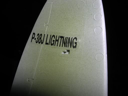

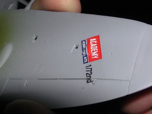

Ant Posted February 22, 2008 Author Share Posted February 22, 2008 Here's a comparison of a couple of Academy decals applied using Mr. Mark Setter / Softer and Tamiya X-20A thinners, onto a primer only surface. I applied these to the underside of an old Airfix 1/48 spitfire which I use for testing purposes. The decals are in the same positions on different wings. I positioned the decals over a lump and over a panel line formed by the join of the ailerons to the wing. The first couple featuring the Academy logo were set using Mr. Mark Setter first, followed by Mr. Mark Softer. As expected, the Mr. Mark Softer caused the decal to wrinkle up and then settle down to the final effect overnight. Pretty damn good I thought. The next set of pictures featuring the decal "P-38J LIGHTNING" was set using nothing but water to initially place the decal on the model followed (after pressing down and drying with a tissue and waiting 5mins) by a drop of Tamiya X-20A acrylic thinners. It wrinkled up very quickly but settled down overnight. Also pretty damn good! In fact, probably just as good as the Mr. Mark products. I'll test out the meths method soon and report back with pictures. Link to comment Share on other sites More sharing options...

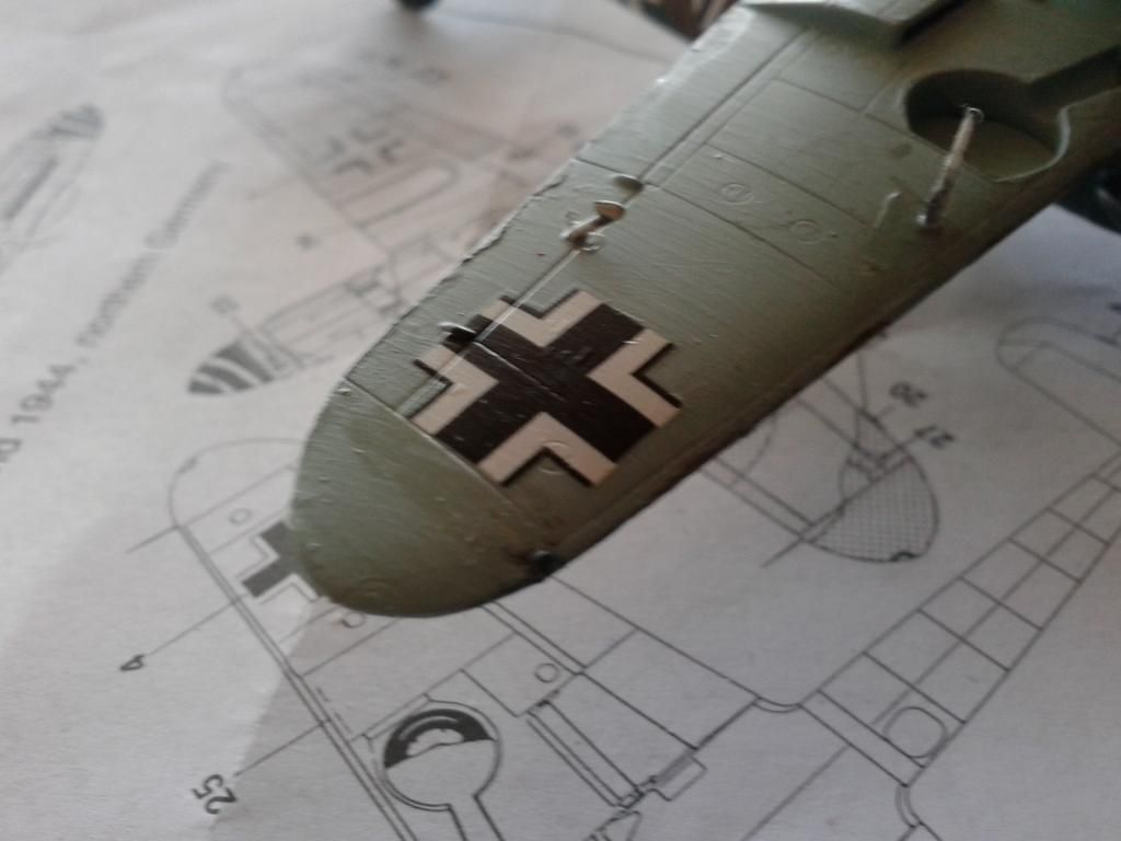

mtchllro Posted January 24, 2015 Share Posted January 24, 2015 As a skint father i looked around my house looking for something to soften my decals I noticed my daughters nail polish remover contained water (aqua) so I thought I would give it a try with a neat solution it just erased the decal lucky it was a test piece I tried various solutions and ended up with a 50/50 water to polish remover ratio , I soaked the decal in water to loosen and using a spare paint brush wetted the area where I was going to try the decal with the solution moved the decal into place blew on it to remove any excess water and then brushed over it with the solution again the effect was almost instant with the decal setting in all the panel joints etc cost me nothing but time and smells nice aswell (perfumed lol) the model is a test one I've been using to test out various paints etc so have no idea which paint it is I will see about getting a pic Link to comment Share on other sites More sharing options...

mtchllro Posted January 25, 2015 Share Posted January 25, 2015 (edited) thanks for the heads up I was just amazed it worked the only paints I have been using so far are the ones from starter sets and it hasn't effected them so far but I will keep a eye on it. Excuse the painting and the quality of the photo but you can see the decal has settled in even picking up all my horrible brush strokes, I have noticed a bit of " silvering" if that's the correct term but only when the light catches it. I knew the painting was rough but close up boy its bad still its only my test piece. Edited January 25, 2015 by mtchllro Link to comment Share on other sites More sharing options...
